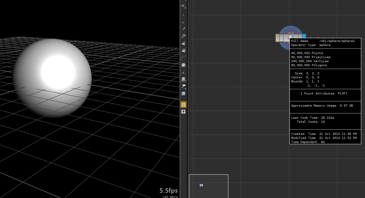

sami.tawil
Good news on GX titan.
I tried again the 16.000.000 poly test and i was averaging 22 fps up to 37 fps..
I tried a sphere with 80.000.000 polygons and i was at 11 fps
what just happened, is it the divers or did you do something to houdini.
just feels so much better

i dont know why or how but now both drivers 331.58 and 320.49 are at 12 fps
It seems they are both good.
probably a background program was slowing down houdini
so yes 331.58 is as good as 320.49
i tried again with the 331.40 and houdini still doesnt start
here is the 80m poly sphere so you can test your performance on your gpu
