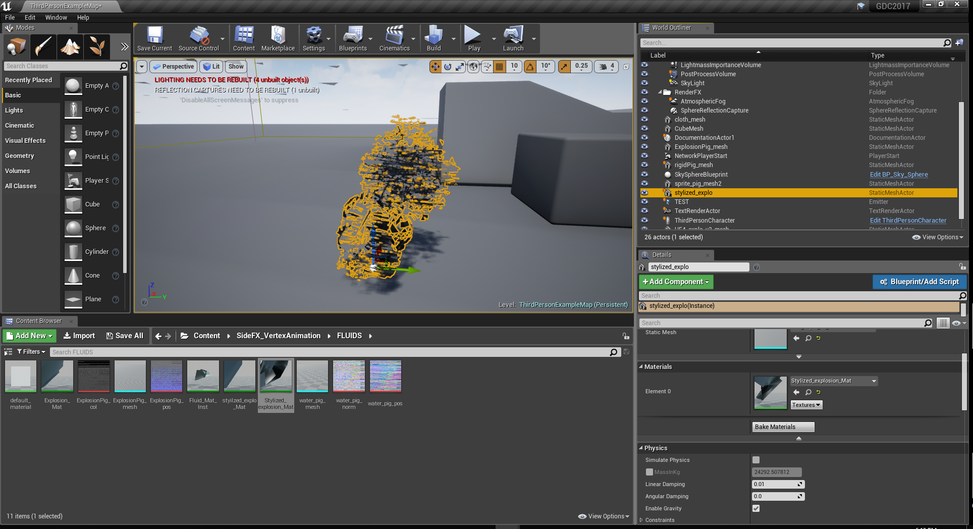

Hey folks, I've followed Luis's tutorial and looked at the scene file, but every time I export vertex animation textures from Houdini, it only shows up as triangles. Any ideas?

Yes it's a fluid sim. I loaded up the GDC2017 project and simply exchanged the color and position textures and mesh.

Hey following up on this as I started a project that utilizes this feature. I have the correct shader on export from Houdini and made sure high precision uv's were checked on the mesh within unreal. but i still see triangles. Anyone else experienced this and know how to help? thanks again!

I think I figured it out. In the material instance, I had one extra frame under “number of frames”
