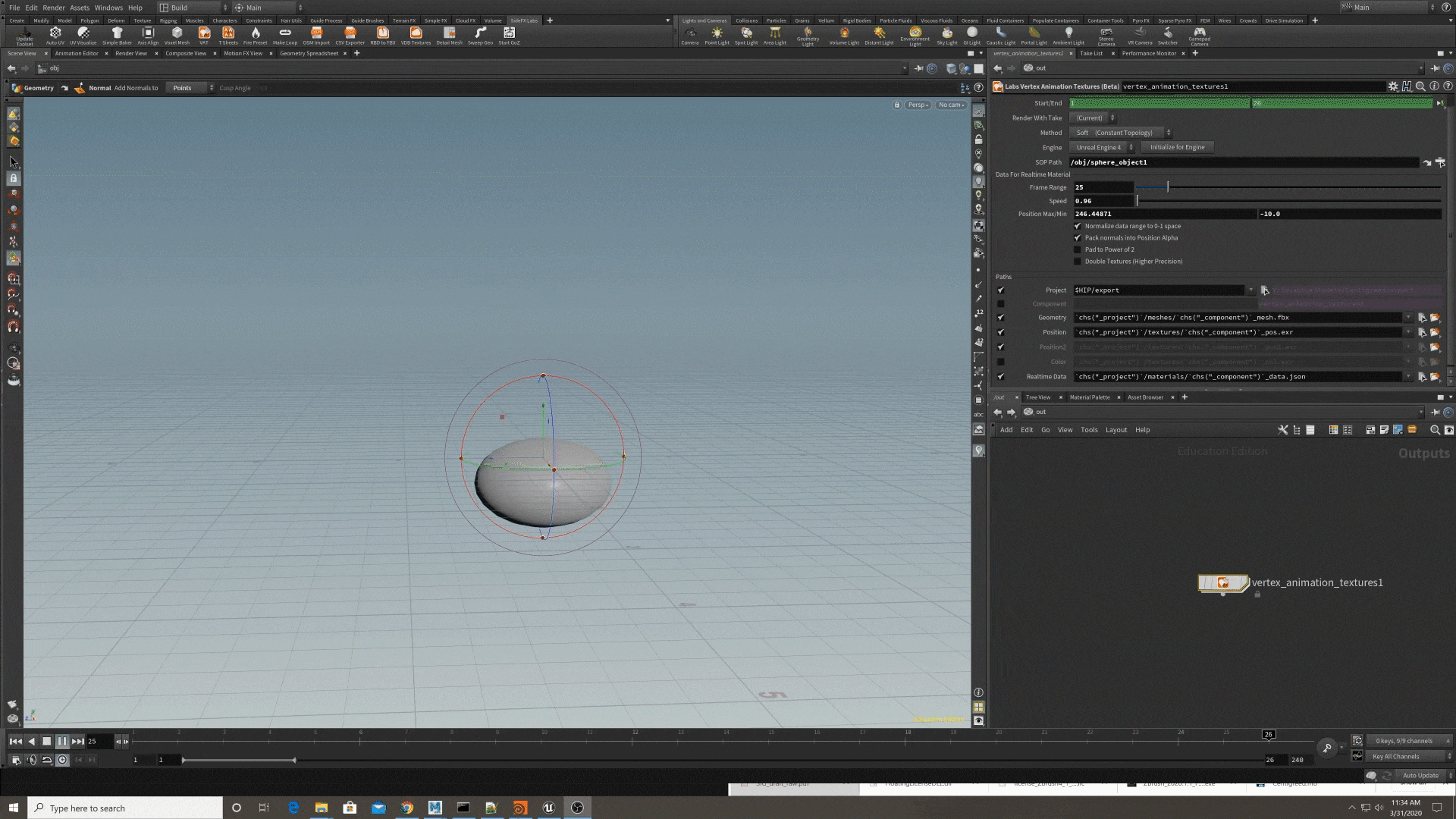

I am testing out the Soft (deforming objects) option in UE4 with a simple test file, a bouncing sphere.
I went through the whole process, and the translation to UE4 is not working right. Here is the animation in Houdini followed by the results in Unreal Engine:
Looking at the Debug node provided in Houdini, it looks different (more correct) than what I see in UE4. I have tried combing through the tutorial, my guess is there's a disconnect with the way that I'm hooking up the texture object to my material function. There's a Normal Map and Color Map input that affects the customized UVs, but I'm not certain if that's necessary or not.
What could I be missing that causes the object to tear apart in UE4?

Thanks for such a quick reply!
The texture compression is set to VectorDisplacementmap, and the instance values are set to the following in the UE4 material instance:
numframes: 25
positionmin: -10
positionmax: 246.4487
Those are the only values I get from the VAT node (where my method is set to Soft). Are there any others I should be setting? The Rigid method gives more.
In the debug, the sphere is skewing off in a diagonal direction instead of up and down. But if I can even reproduce that in UE4, I feel that I'll be a ways further on the right path.
Also, I have UVs on the sphere, a simple Polar mapping.
numframes: 25
positionmin: -10
