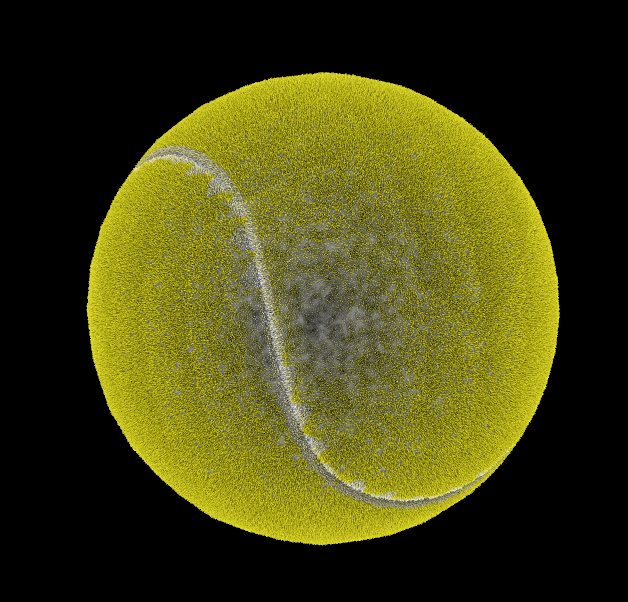

Any suggestion for how to create fur for Tennis ball..
Chetal A Gazdar
Joined: 2月 2019
To keep it simple you could try copy to points with a bunch of tiny lines, with jitter or noise. The entagma tutorial on path deform in 18.5 uses a similar technique for moss (starting around 6:30) https://youtu.be/-TsA7nmivfA?t=394 [youtu.be]

MonikaSeles.hiplc (593.2 KB)

Thank you both for valuable response

I created one tutorial for the same.. thank you both for gave some valuable suggestions..

How would you go about adding a logo to this ball and also be able to change the logo colour?
https://www.sidefx.com/docs/houdini/nodes/sop/guideskinattriblookup.html [www.sidefx.com]
Can be used to pick up uv from the geometry at the root of curves.
