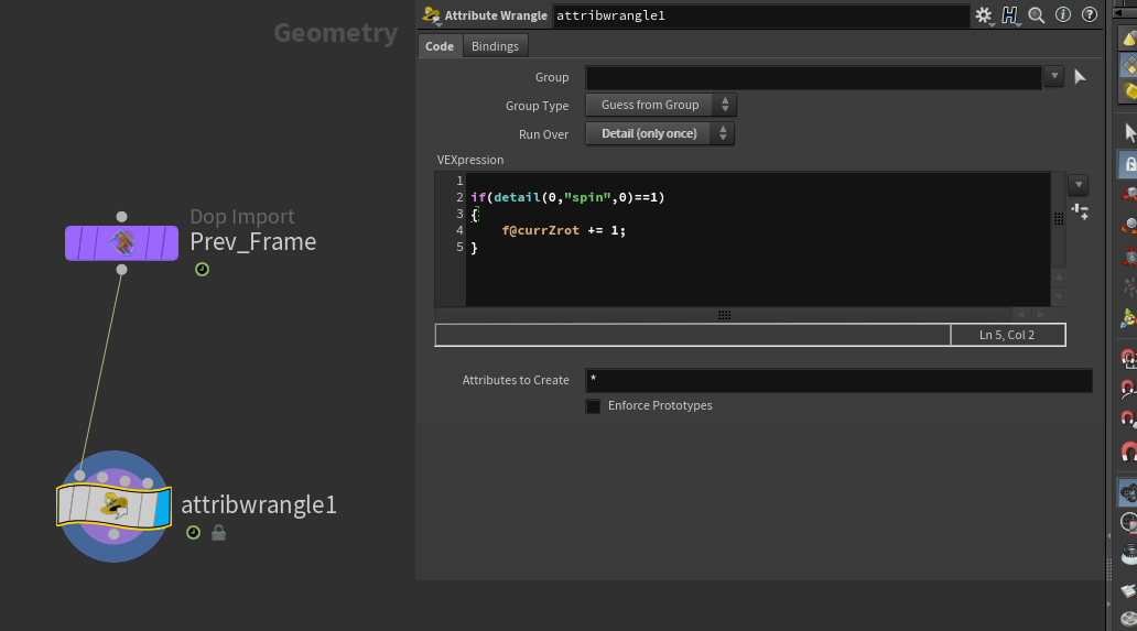

this does work inside of the solver sop, but when attempting to change the condition while running, it doesn't seem to work. I need to conditionally update this attribute depending on another attribute:
if I stop and reset the simulation, it works, but not while running if I change the "spin" attribute to "0"
if(detail(0,"spin",0)==1) { f@currZrot += 1; }

You are taking the spin attribute value from the first input which is geo from the previous frame in your case so that will always have spin value from the start frame unless changed within the solver
You can either sample the first input geo of the solver itself for the spin value
Or instead of operating directly in previous frame geo just copy attribs you want to preserve from previous frame geo onto live input geo yo further modify them
This will leave all other attributes live and updating from input
