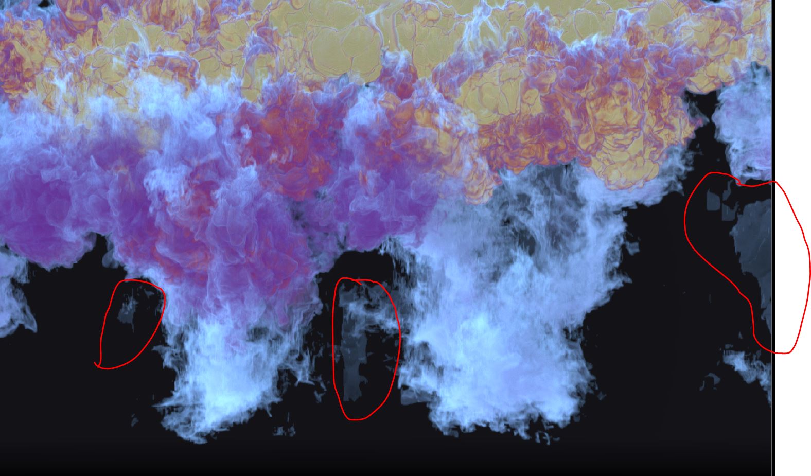

I'm wondering if there is a way to delete part of a fog volume like you can with regular geo or with a vdb combine. I have this smoke that is colliding with an imaginary back wall, it's helping give a nice shape to the smoke for the effect that I'm after. As it's sliding down the back wall I'm getting some funny artifacts that I'd like to get rid of. Ideally I'd like to create a very thin region with a box that can delete those areas right at the back.
See artifacts here. Hey are extra noticeable in motion.

I'm not sure if I understand your question correctly, but if you want to create a kill box in your scene to kill parts of your fog volume, I'd set up an SDF kill box, and run a couple of lines of vex to make the density of your fog volume 0 where the SDF is <= 0. I'll attach a picture showing the results and the vex code. (The VDB from poly node on the right should have the name "make_sdf".)

Yes that did the trick thank you!
