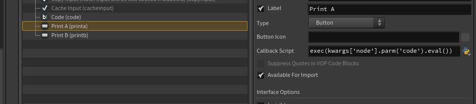

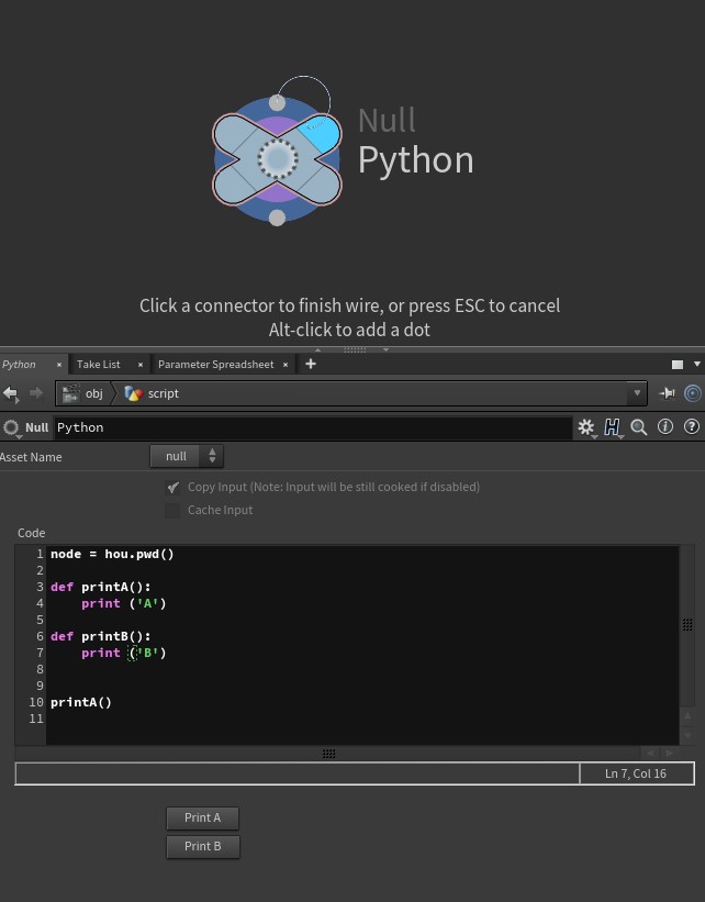

Hey Guys,
I am trying to execute functions from inside a string on click of buttons.I was able to execute whole snippet,but not able to setup the callback for calling specific functions by pressing specific buttons.Please note that it`s not an HDA,it`s working fine with HDAs using hou.hdaModule,but I want to call these functions on a node.Posted Images should give you a better Idea of my issue.
I have also attached the hip file
Edited by MarXindia - 2022年9月2日 09:25:17
Python Printdef.jpg (53.3 KB)
pythonCallback-02.hipnc (89.2 KB)

Try specifying the function after the eval, basically running another line of code within a single click.
exec(kwargs['node'].parm('code').eval());printB()
Edited by Enivob - 2022年9月2日 10:58:38
Using Houdini Indie 20.5
nVidia 3060RTX 12BG RAM.
Joined: 9月 2013
Enivob
Yay it works .I did find a workaround though, that looks like below,
exec('{}\nB()'.format(kwargs.parm,('code').eval()))
your solution seems pretty straight forward and convenient,Thankyou Enivob
