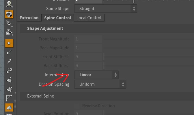

How can I extrude tubular shapes without bad topology, if the extrude divisions > 1? What is the correct way to do this?
extrudeTest.hipnc (435.5 KB)
828 posts
Joined: 2月 2017
Hey AndreG,
looks like it is buggy. You should sign a BUG report.
edit: but setting Interpolation to Linear solves the issue. So I don't know if this is intended.
Cheers
CYTE
Edited by CYTE - 2022年11月18日 03:54:37
Screenshot 2022-11-18 094548.jpg (230.9 KB)
7 posts
Joined:
Thank you. This solves the problem.
