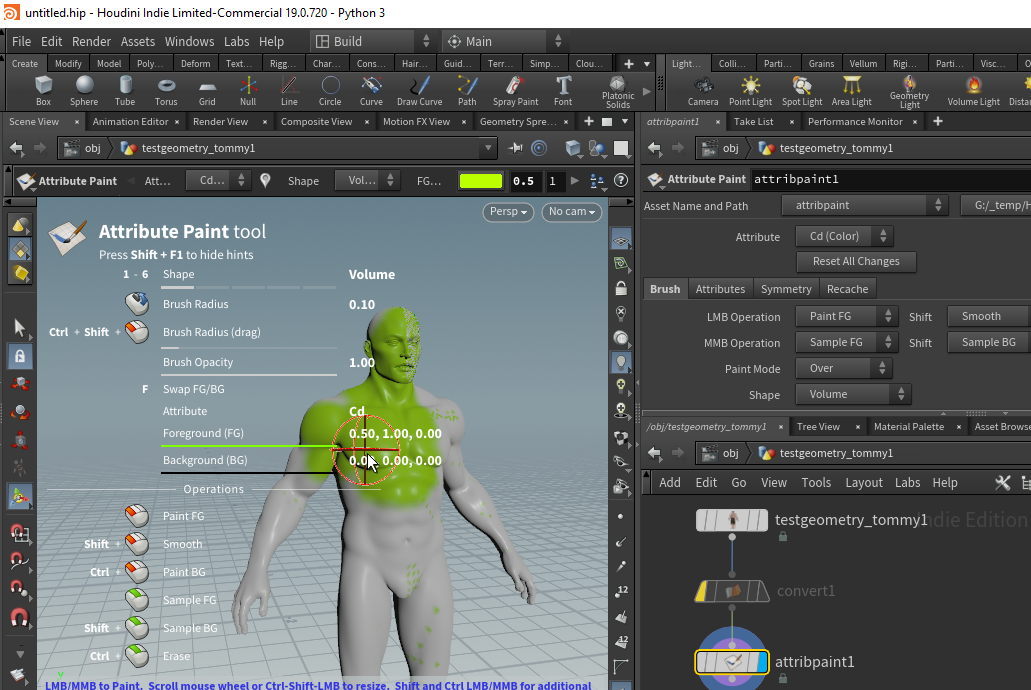

Thanks! Unfortunately, it's not even limited to alembics. Just trying to paint on a sphere or the Tommy model doesn't allow the paint tool to become enabled automatically, or after hitting the Enter key. Adding a screenshot to show that even after adding a convert and attribdelete node to Tommy (which shouldn't be necessary to begin with), that it's still not working:
I can't even follow along with the Houdini Masterclass that shows everything working with only a tommy and paint attribute node, without having to do anything else. :-/
