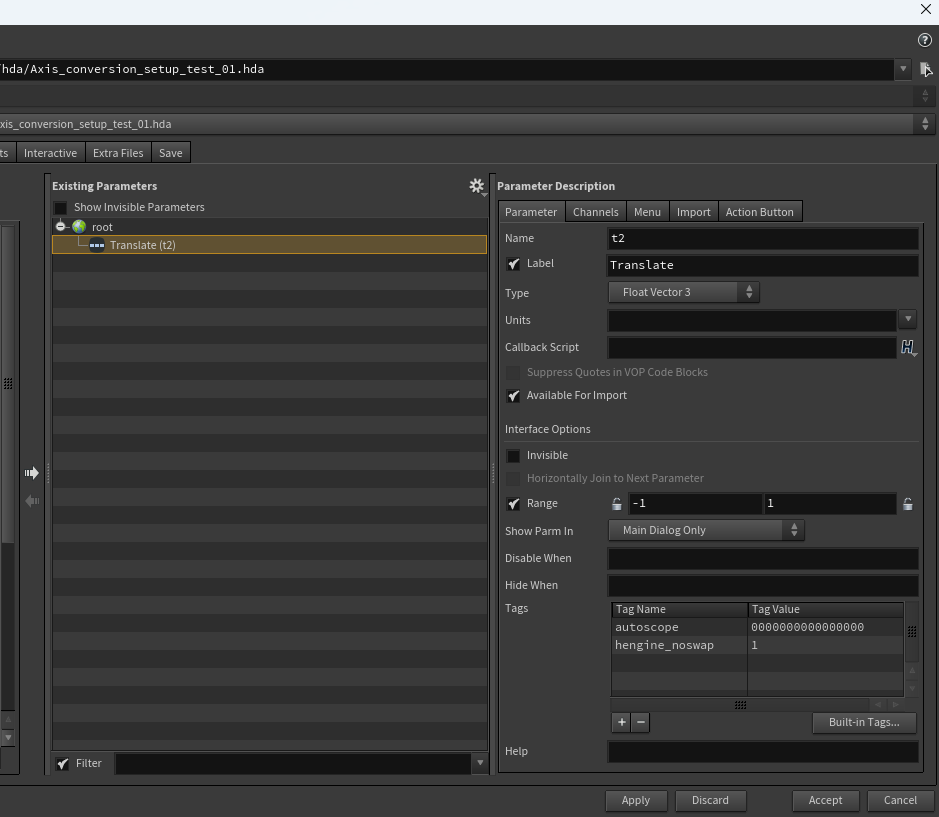

In the type properties dialog, select the Vector3 parameter you want to enable noswap for.
At the bottom right, you'll find tags.
Click on the + button to create a new tag, name it hengine_noswap, and set its value to 1.
Apply the changes, save the hda.
In unreal, changing the Y value of the parameter will also change the Y value in H, same for the Z value.

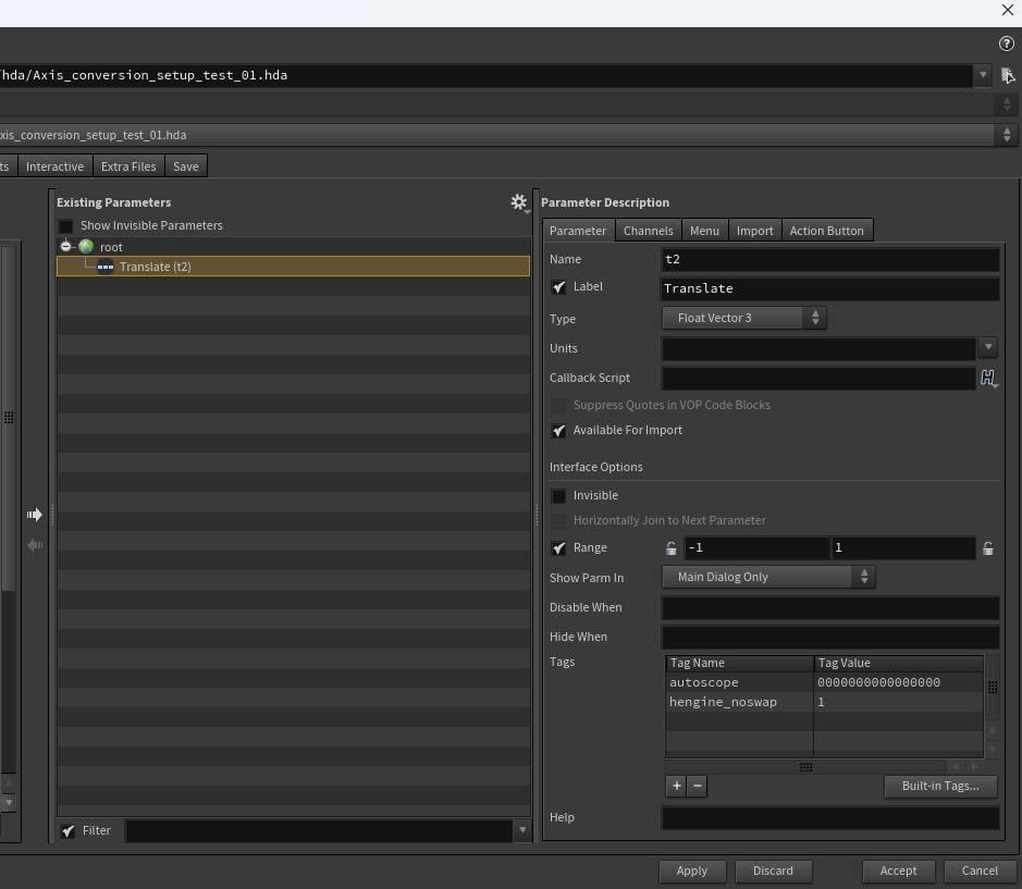

Hi Damien, here's what I don't understand. I'm dragging the translate node of my pighead node and attaching the hengine_noswap for the name and 1 for the value. But when I rebuild my HDA inside UE5 I don't see a change. What am I missing? thank you!
