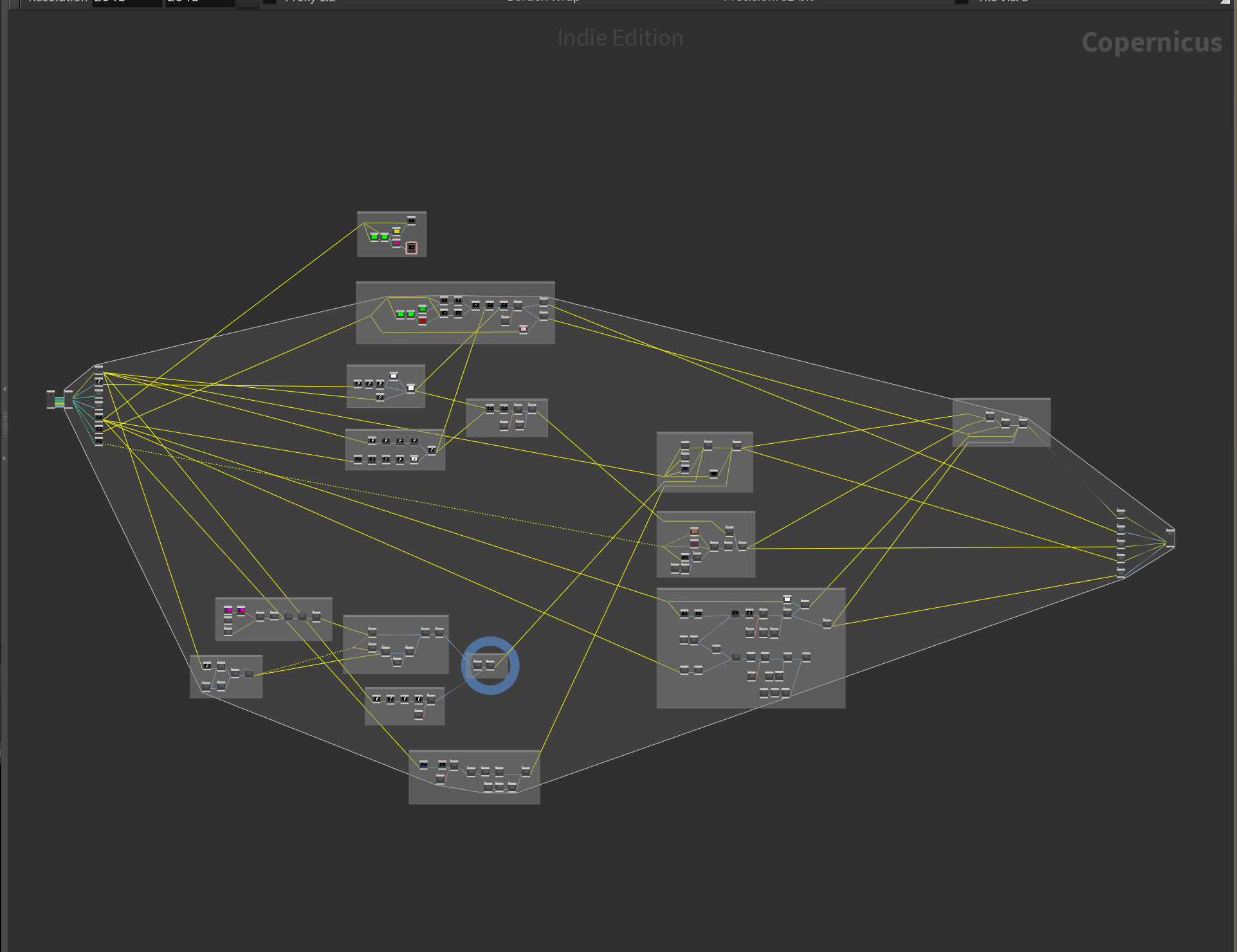

Does anyone have ideas on how to keep network graphs tidy?
I'm working in a COP network (Copernicus) and despite trying to keep it clean with network boxes and dots, I'm still finding it pretty chaotic with visual clutter and crossing wires.
Working in the graph becomes problematic too. When moving nodes around, they sometimes accidentally snap onto stray crossing wires (where the node takes the crossing wire as an input) when all I want is to move it to a different spot on the canvas.
In COPs, inputs all come into the graph from the same import node, so if an AOV is used multiple times in the network, it's hard not having wires cross.
I am wondering if it's possible to have a given AOV come into the network in more than one node? On second thought, I can see this causing more problems than it's worth because if the number of AOVs changes, you'd have to update all the import nodes separately.
I am used to working in other editors, like the material editor in UE, where you can drop down a named reroute that allows one section of a graph to be referenced somewhere else in the graph by name. Is there something like this in COPs?
Any thoughts?

I think of a node graph as a circuit. See the last image for reference.
Try LMB on the wire while holding ALT button. It will create a pin on a wire. You can create as many pins as you want.
My first thought is to create multiple Nulls (and name it) after the initial file with all AOVs. Plug each AOV in the corresponding Null.
I believe no, yet.
I feel Nulls are similar but there's no "object merge" in COPs like in SOPs land where you can create a Null, and use Object Merge to reference that Null which pulls all of the data from a specific node branch.
I feel you're talking about something like Substance Designer with its Portan Dot node [helpx.adobe.com]
Keep in mind that COPs v2 is still in Beta and I assume many features will be in upcoming versions. Epic Games worked on Material Editor for quite a while..
This is how I tidy COPs and node graphs in general
Using big text and numeration flow (step 1-2-3-4-5....) helps me a lot to see the flow from start to end of the whole node graph.
Helps to spread wires:
This is essentially the Houdini/UE Material Editor/Substance Designer/Gaea/Blender Geometry Nodes node graph.

Thanks so much @AnimGraphLab! This is very thorough and helpful.
Your node graph looks very tidy, but I question how easy it is to maintain cleanliness like that when testing, iterating, and when you don't necessarily know the order of operations in advance. For me, the process of working on a graph feels like it involves a bit too much clicking and noodling with wires.
Dots are useful, but for one, I find having those elbow dots floating in empty space to be difficult to manage, especially if a number of nodes need to be inserted in the gap inbetween.
Another issue is that I find the wires tend to be hard to see when they span across large distances. Is there a setting for wire opacity somewhere?

davidbk
By allowing yourself to get confused, which may lead to understanding how to get out of it (workflow)
I don't have a simple answer as I feel that it's subjective and varies from person to person
davidbk
It is true. It is how it works, for now. Is that much different in UE Material Editor? Curious.
davidbk
On the attached image is it not your network view?
If not, to change wire opacity in the network view:
- however over the network view.
- click the D key.
- General tab -> Long Wire Fading parameter. Set it to 0.
