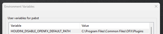

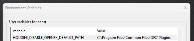

I have this very same issue with Houdini 21 but I'm not sure what steps you have to do to fix it.
I followed these steps from the link but replaced step 3 with "HOUDINI_DISABLE_OPENFX_DEFAULT_PATH = 1", resulting in the following steps, still it doesn't work for me. Am I doing something wrong? Could you please Confirma the rigght steps?
1-Choose Start ▸ Edit environment variables for your account.
2-Click New.
3-Set Variable name to "HOUDINI_DISABLE_OPENFX_DEFAULT_PATH = 1".
4-Set Variable value to C:\Program Files\Common Files\OFX\Plugins.
5-Click OK.
6-Log out and then log back into Houdini to use the OpenFX plug-ins.

Sepu, or any other member who succesfully fixed it. Could you please explain, step by step how to disable the OFX paths just for Houdini?? How to disable the OFX path to prevent COPs from loading installed OFX plugins?? I tried the steps in the link and it didn0t work for me.
Please help!
Joined: Nov. 2016
The above instructions are a little confusing.
This worked for me:
1. Open Environment Variables window (Start menu, start typing "edit system" and "edit the system environment variables" should pop up as an option)
2. Click on Environment Variables button (bottom right)
3. Create a new System variable (Bottom "New" button)
4. Variable name should be: HOUDINI_DISABLE_OPENFX_DEFAULT_PATH
5. Variable value should be: 1
6. Hit OK
7. Houdini should now launch without OFX errors
