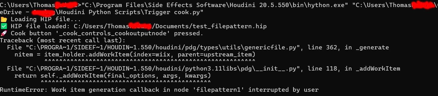

Hi there,
I'm trying to run a TOP network in a headless Houdini session, but I'm encountering an issue with the File Pattern node—it throws a "file pattern interrupted by user" message.
Interestingly, everything works fine when I run the same setup from Houdini's built-in Python shell.
I've attached a simple .hip scene as an example. It includes a File Pattern node followed by a ROP FBX Output node in TOPs.
Could anyone help me understand what I might be doing wrong when running it headlessly?
Thanks in advance for your help!
Screenshot 2025-05-19 105702.png (63.2 KB)
Screenshot 2025-05-19 110450.png (83.9 KB)
test_filepattern.hip (171.1 KB)

Pressing the cook button on the TOP triggers a non-blocking cook, which mean the cook runs in the background. This is typically not suitable in a headless session because nothing will wait on the cook to finish, and it'll be canceled when it reaches the end of your script and Hython exits.
If you're triggering a cook programmatically in a script you should use one of the various hou.TopNode methods to do so, and pass in the block=True argument. That way your script actually waits for the cook to complete. For example: https://www.sidefx.com/docs/houdini/hom/hou/TopNode.html#cookOutputWorkItems [www.sidefx.com]
Joined: Dec. 2024
Fantastic! You made my day. Thank you—it works perfectly now.
