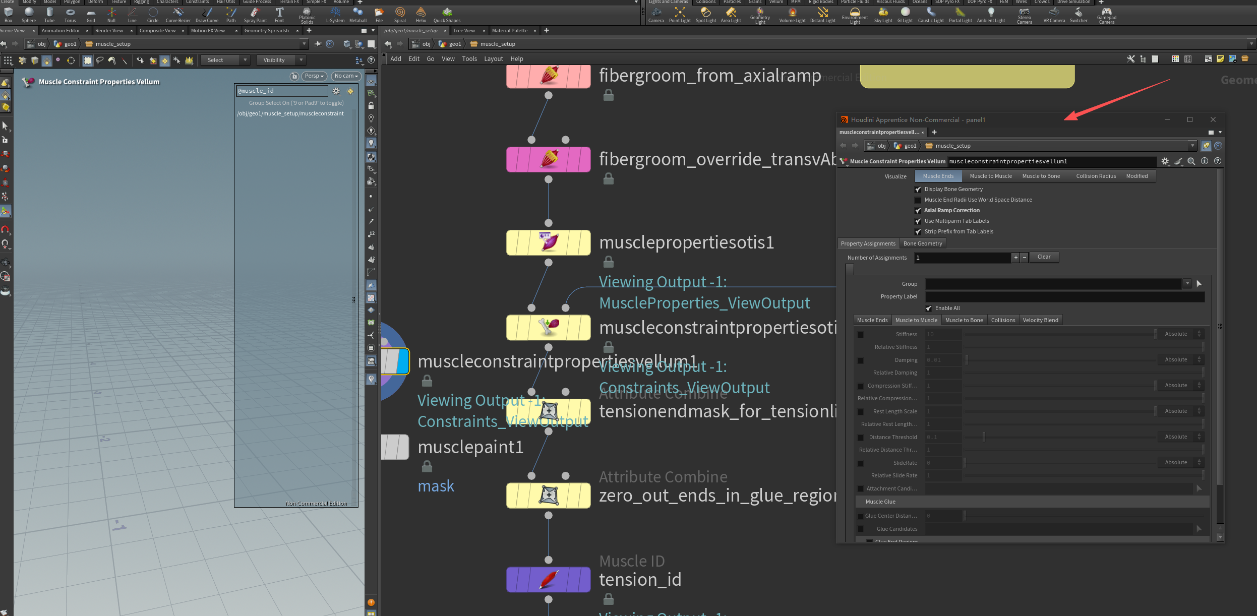

I'm currently working on a muscle simulation setup in Houdini 20.5.487, and I've encountered a strange issue related to the Muscle Properties SOP node.
As soon as I move my mouse into the 3D viewport while the Muscle Properties node is active in the network, I get the following Python error in the console:
This only happens when the mouse is over the viewport — if the cursor is over the network editor or parameter pane, the error does not occur. Everything else seems to work fine, but this error pops up repeatedly whenever interacting with the viewport.
Has anyone else experienced this issue? Is this a known bug or is there a workaround I can try?

参数窗口不能用快捷键“P”画中画的形式出现。需要独立窗口,而且要把 following selection 激活。

Unfortunately the Viewer State cannot currently find the parameter dialog when it is an overlay in the Network View like you get by pressing "P". Instead, you need to have the parameters in a separate pane or window as gordon_lei mentioned above. I personally like the "Technical Wide" desktop as it lays out the parameter pane to the right of the network view, instead of above it. Although hot tip, if you Alt+LMB on the middle of the divider between two panes it flips their orientation, which I often do when using the "Build" desktop.
As for the bug itself, I could add error handling for it, but the Viewer State won't interact correctly with the multiparm tabs, so I will ask the relevant developer to add the multiParmTabs function to the NetworkEditor class.

The multiParmTab and setMultiParmTab functions have been added to hou.NetworkEditor in H21.0.489 and H20.5.737. Using a floating parameter pane in the network view now works with viewer states that interact with multiparm tabs like those used by many of the muscle nodes.
