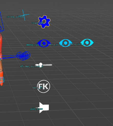

there a some examples where users customized the abstract controls in their rigs. are there any docs about this or even demos. it would be cool to adjust the look of the abstract control so that is self-explanatory in the viewport

You can change the look of any control using the configure controls node. The second input on the configure controls can be used to add custom shapes.

Thanks, configure controls works.
But I wonder how that advanced controls are build, that are used in the electra rig for exammple

Hi here are some examples of how to create controls groups and custom triggers.
