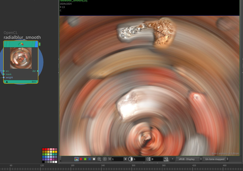

Need radial blur? Make it yourself with blackjacks, masks, and weights. OpenCL is amazing.

831 posts
Gaalvk
Hey Gaalvk, this looks great! Would you share your radial blur code?
Cheers
CYTE
123 posts
Joined: March 2025

I sent you a private message.
Honestly, the snippet is still just a half-finished project for use in a previous task, but it seems to work. Please let me know if it worked for you. I'm not sure this is the best code .
To exclude blur, either a mask or weights, or both, to be honest, I don’t remember.
