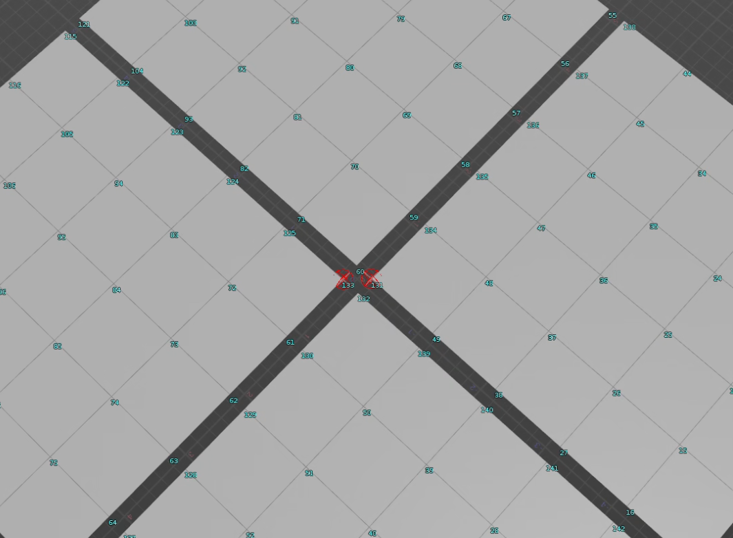

Hello,
I want to use the weld integer attribute to weld points together in a solve. but some points need to be welded to more than one point. some cloth patches that meet at the corner.
is that possible at all?
martin
Weld more than two pints in a weld for a vellum solve
