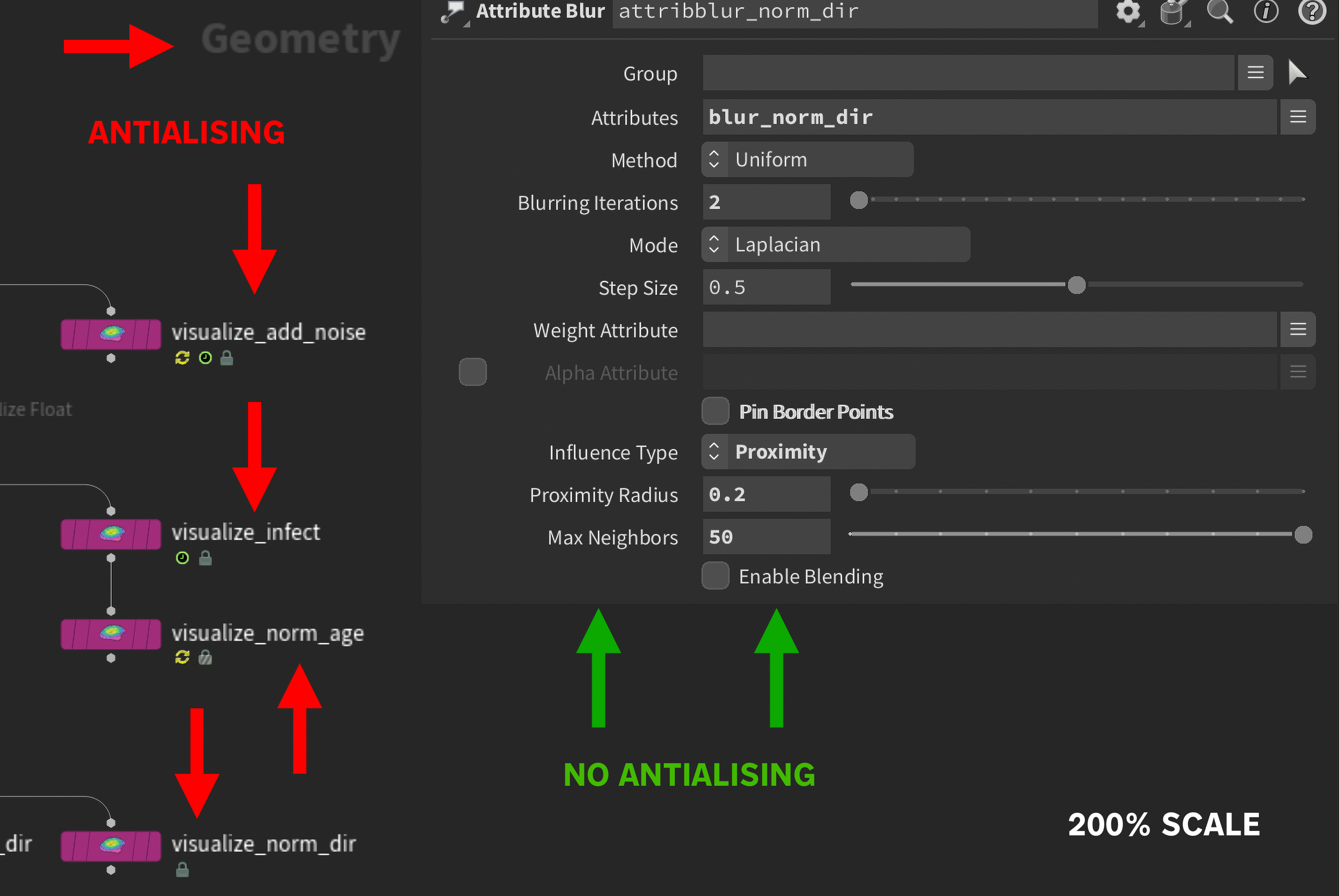

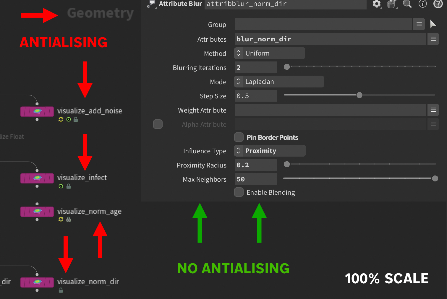

Thank you all for your replies and suggestions.
I increased the interface contrast, and this has made the problem noticeably less apparent. It is not completely solved, but the text is now easier for me to read.
I am attaching two images shown at 100% and 200%. I hope they make the issue I am referring to more noticeable.
The main difference can be seen between the text on the nodes, which has much more pronounced anti-aliasing, and the text in the parameter interface, which appears to have only slight anti-aliasing.
The final image shows a typical situation in which I need to zoom out in the node graph to see the sequence of nodes, check for possible errors, and understand the overall structure. At that zoom level, the node text becomes particularly difficult for me to read.

This just looks like a bug, you should report it.

yeah, looks like it's rendering the network editor text at half-res
