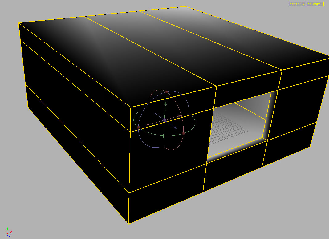

thanks robert\pagefan, i am using the import geometry, i import the file as a version 5 *.lwo as it failed to load the version 9. All i see when i select the import geo node is a wire representation on the object, deselected it disappears..

seems to work now, it renders normal, flat shaded and smooth shaded fail to display the model, maybe its a videocard issue..

no videocard issue, geometry created inside houdini displays fine, just not the imported one.

well, it renders bog-ugly, and even the opengl model looks like it unmerged all polygons and smoothing is applied over corners, all kinds of funky shading going on. It would have to render fine with default mantra settings, wouldnt it?

Yep, normals are smoothed over all points by default. For first aid put down a Facet SOP and tick the “Unique Points” box. That un-merges the points and the edges will look hard.
eetu.
4140 posts
I think that's what he's using. How the obj is created can be critical. Try adding a facet SOP, recompute the normals, try consolidating points.

added facet SOP, PREcompute nomals, consolidate points as far as was possible, still looks like it did..

the consolidate points in the clean SOP did it!
