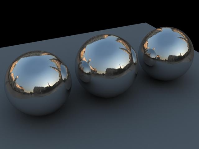

When I render a test image on local machine I get “good” picture.
When I try to render it with mantra -H render1, render2 (network computer names) command i get “bad” picture.
It looks like it is some problem with paths, but I cannot find a solution.
