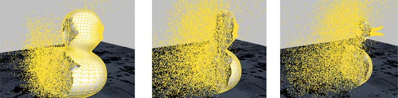

hey guys. have a question, i need to create a particle effect like this photo by using the houdini particle system, but i don't know hao….
could anyone tell me the best way to do it?

There are alot of different ways to achieve that . You can do it by just deteriorating the image and composting a animated ramp between layer a and then deteriorating particle version. birthing particals with color info transferred from the animated range of the ramp withthat traveling over the length of the object. There are many examples in the help (f1) open them and look at the files. you can learn sooo much from in there by breaking down the examples. Each node has notes that you can access by clicking on the gear and choosing “edit comments”

Well the very first thing you should do is sit down and break down your concept and get out on paper/wacom exactly what you would like to achieve. Start out without drawing. just describe what you want to happen like a script. Figure out how long the scene/s will be begging to end. Brain storm. The next step is to draw frames of the most basic and the most spectacular of your shots without thought of weather or not you are able to do it or not (sky is the limit attitude) It is through these concept sketches that you can begin to realize and figure out timing of what you want to happen and when . you can arrange the sketches into story board form and then write notes below the frames if there are to be cues to sound etc. Once you have done this you can then single out each type of event (text emit, object emit debris etc.) . You could do this many ways in Houdini in one fell swoop using the “switch” node and copy node with various “stamping” . To get hands on examples of the nodes just lay one down in your network area and click on the question mark.
Essentially what you want to do is to have a traveling range to source your particals from . You can do this by laying down a group sop and choosing “range” in the “operation” section under the “Number” tab. You could use an expression to have the range travel. By doing this. You can create a group of points or primitives that you can call upon in your “source” Pop to birth debris/numbers/dust/and so on. from. To access the group. After laying down a popnetwork. jump into the network (hit the letter “i”) , lay down a source pop, choose your group from there.
There is much to do just keep to your plans and experiment , look at some examples of each of the nodes . you will learn fast the possibilities are endless. To bring everything together, the most flexible way to deal with this will be to composite layers of before and after to give you more control over some of your elements. You can then use more animated masking to really funkify your scene.

Ha! No, my brain is quite average sized for a human. hehe. You will find that Houdini is addictive and will be difficult to go back to using less flexible tools once you start seeing the benefits of truly procedural work from begging to end.
I hope you enjoy exploring. Take it one step at a time. You will find that the more planning you do on the look you wish to achieve, the less time you will spend messing around(well a little less) with experimenting with looks. Once you get to the stage where you can have many sources with the pop merge bringing them together or separate birthing from multiple interacting groups (look at the “interact” pop examples) plus the “collect”, “creep” and the “group” based on age or life of particals in planed use will help your task as well. Look at examples for these partical oporators.

I decided to have a little play with an idea in my head after thinking about eroding geo and birthing from that with animated deteriorating . you just have to figure out how you want your particals to flow. Planning and more planning and you will do it . ( your computer willing )
:idea:
jatero_errode_concept.mov (183.9 KB)
