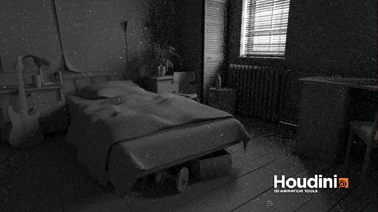

I am getting white specks in my render with PBR. I am not talking about noise - I can see the image is noisy. I am talking about all the pure white specks that are all over the image. I have tried adjusting every setting I can think of, but I still get the specks. Anyone know what the problem might be?
HIP file is too large to upload here, but here are my settings…
-2 Area lights with raytraced shadows (16 area samples each)
-PBR renderer
-Pixel Samples 3X3
-Min Ray Samples 20
-Max Ray Samples 40
-Diffuse Limit 3
-Raytracing Bias 0.01
4393 posts
A ‘hacky’ approach is to add the Color Limit property to the Mantra ROP and set its value from 1000 to something like 5. It limits the intensity of a sample which can help get rid of speckles. (Which are generally caused by secondary glossy bounces.)
382 posts
Joined: Oct. 2008
This is being caused by using an area light set to “physically correct.” The white spots are reflection bounces. Haven't really figured out a way to get rid of them unless I change the light setting or set reflection bounces to 0.
I would prefer not to clamp my values if possible.
Any other ideas?

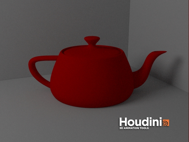

Some more pics + hip files.
Please, if someone can take a quick look, maybe you know what the problem is.
Thanks!
gi_test_physically_correct.hipnc (500.4 KB)
382 posts
Joined: Oct. 2008
Half-distance file in this post.
gi_test_half_distance.hipnc (500.4 KB)

9728 posts
Joined: July 2007
that post is 5 years old
do you have fresh scene where you see white specs?
that problem was usually resolved by changing the noise level/max samples and decreasing Color Limit
if you are using former 5 year old scene, try replacing mantra node with new one, and maybe materials as well
