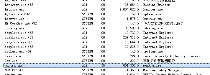

I have xeon 5620 * 2 on my workstation.
but , when i creat a mantra rendernode and start my render.
mantra alway only use about half cpu in rendering progress.
I allready select to use max cpu.and tryed 2 custom the value to 16.
but mantra still use half cpu.
and it's nothing wrong with anyother program.like 3dsmax maya etc.
ram useage is not full ,about 4g ram free now.
why case that? and how to fix that?

not all the cores is physical.
but mantra only use one cpu.
for example:
CPU1 is core 0~7 CPU2 is core 8~15
mantra always use core 0~7 and core 8~15 is not used.
or mantra will use core 8~15
i have a mac pro .i will try mac houdini to test this issue.
