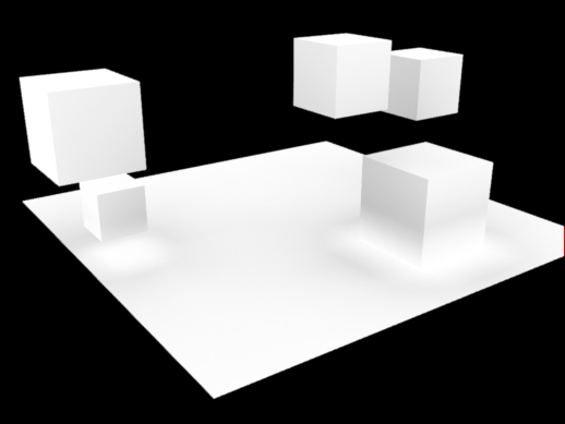

Hi, I installed the latest Houdini 12.0.564 and render the same scene as shown above using the same hip file downloaded from this post, but I get some strange results regarding ambient occlusion rendering.
Pls see the image below which has some bright splotches that are supposed to be dark according to my previous rendering as shown in my previous post.
Pls kindly advise why there's the artifacts.
Thanks!
- Ji

Occlusion does seem somewhat broken > emailed support about it . On a side note to get you over the bump. Go onto my site, you will find a setup I use for rendering occlusion
rob
Gone fishing

This has been fixed in today's build - Houdini 12.0.565
Side Effects Technical Support
