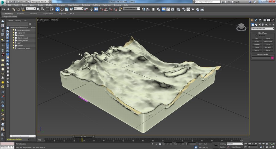

Hello, i already tried the Alembic method, the water simulations exports just fine, but splashes and foam not!, Please i really need to know how to export these particles to 3ds max so i can render with vray, and if you know what shader use on it i really apreciate you could tell me, thank you so much
Sin título1.jpg (73.3 KB)
Sin título.jpg (93.7 KB)

Maybe you could try with hooudini engine for 3ds max. I am just beginning to explorer it so I can't tell yet if it will work.
https://github.com/K240/HoudiniEngineFor3dsMax/wiki/Houdini-Engine-for-3dsMax-Binaries [github.com]
you can also try with the prt exporter for houdini. remember there is a free version of krakatoa you can use for this.
http://www.flipswitchingmonkey.com/2015/01/prt-export-from-houdini/ [flipswitchingmonkey.com]
