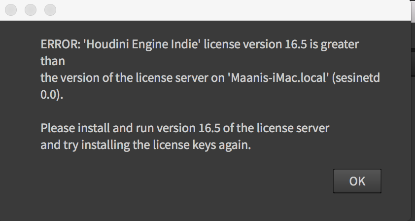

Same problem on my Mac
Joined: Jan. 2018
^ lol same problem on my iMac, and just uninstalled and installed the latest build on the website, and still get this error. (in attachments)
Is there any way around this so I can get my Houdini running on my computer? :'(
Screen Shot 2018-03-03 at 1.12.13 PM.png (54.6 KB)
99 posts
Joined: March 2009
try restarting the license server machine after upgrading the Houdini install on that machine
