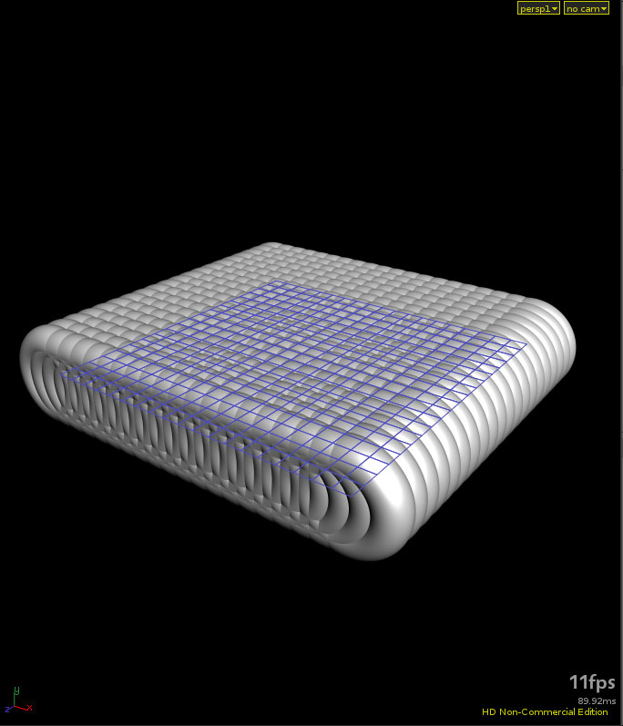

I did a small performance test for the viewport. I copied a torus 200 rows by 200 colums onto a grid, 20 by 20 which gives you 16 million polygons. If you rotate this and check the fps (displayoptions/guides tab) you get somthing realistic to compare. A GTX 480 gives you about 4 fps, a GTX 580 about 5 fps(i7 980x @4.2Ghz). It would be really interresting to know how the GTX Titian performs as I am also planning to upgrade my system (or downgrade???). Judging by all these artificial benchmarks the Titan should give you at least about 10 fps. If they manage to fix that shadow issue (which I truely hope for people who allready bought it) this would be a nice card to own.
