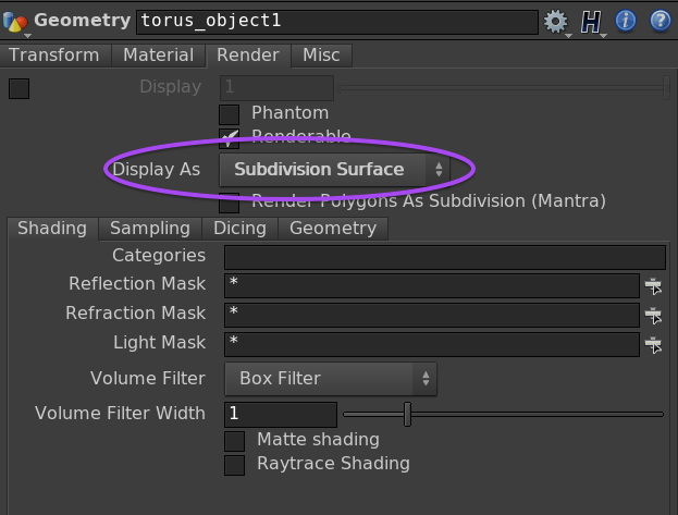

I was looking around in the help file to see how opensubdiv surfaces work in houdini, but could not find much about this?
I tried switching the algorithm in the subdivide SOP but it needs to be cooked first? How does this work? Apparently this was implemented at viewport display level as well.

see attached screengrab

Thanks MartyNz, I appreciate your help.
