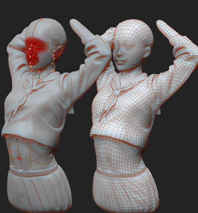

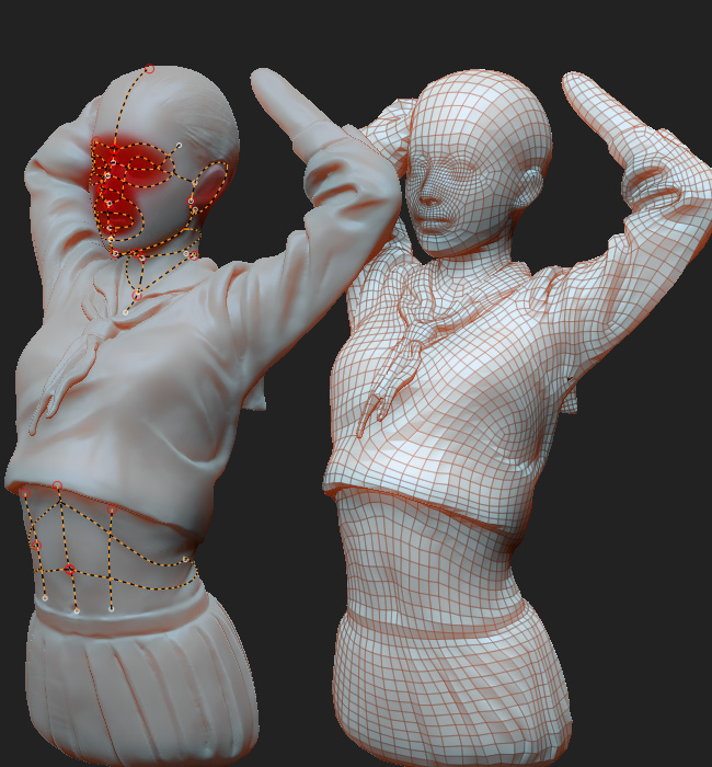

Alternatively ZBrush's remesh tools are excellent. Still poly data, but much cleaner and more suitable for resurfacing by hand if you're starting with high res geo.
