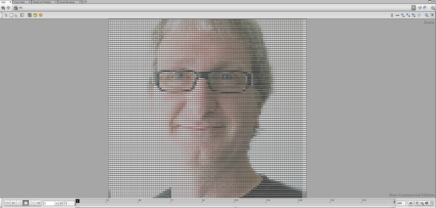

hey guys,
here's some fun art work that ive made in the node editor of houdini. Yes, in the node editor. No photoshop. Im calling it NodeZArt.. cuz its simply art with nodes.. and it has my initials too (ZA)..
Lemme know wat you think…

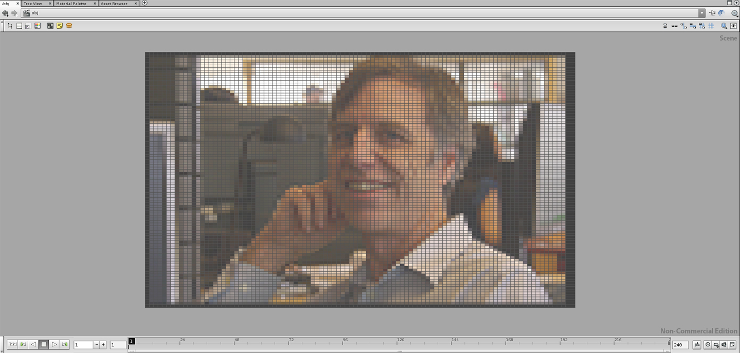

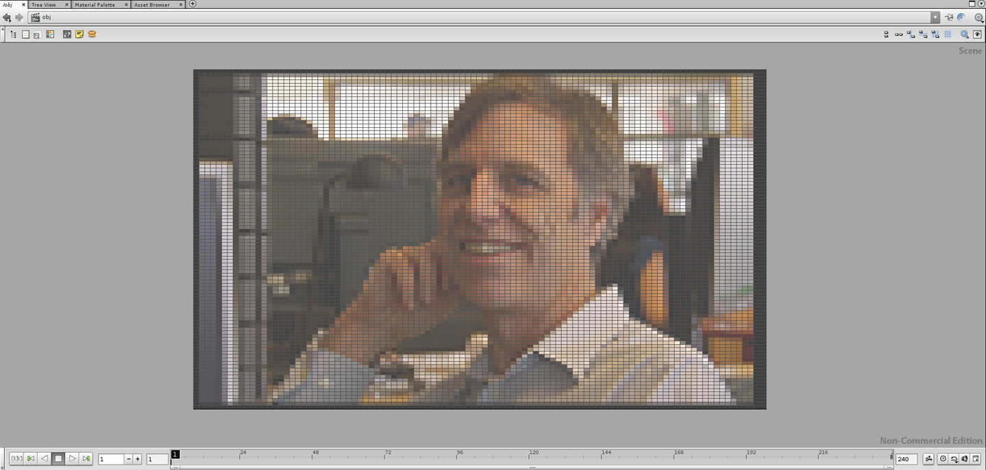

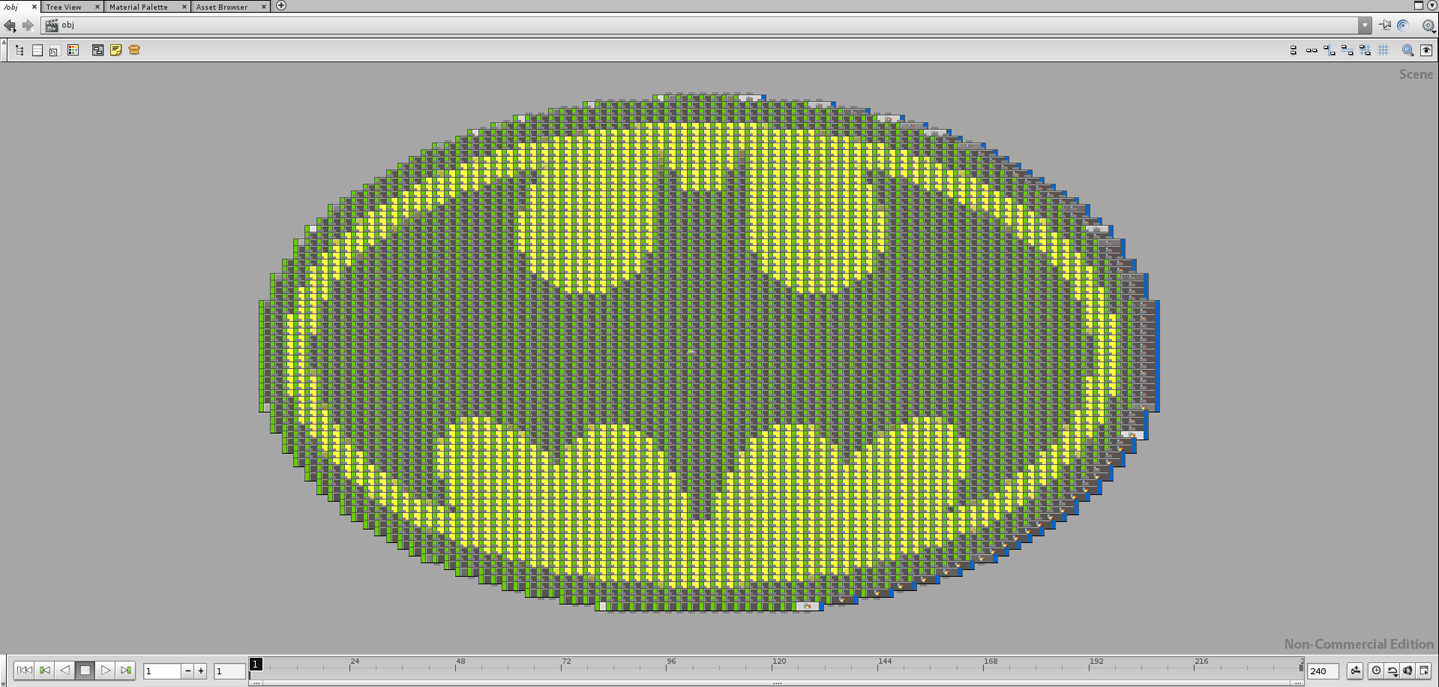

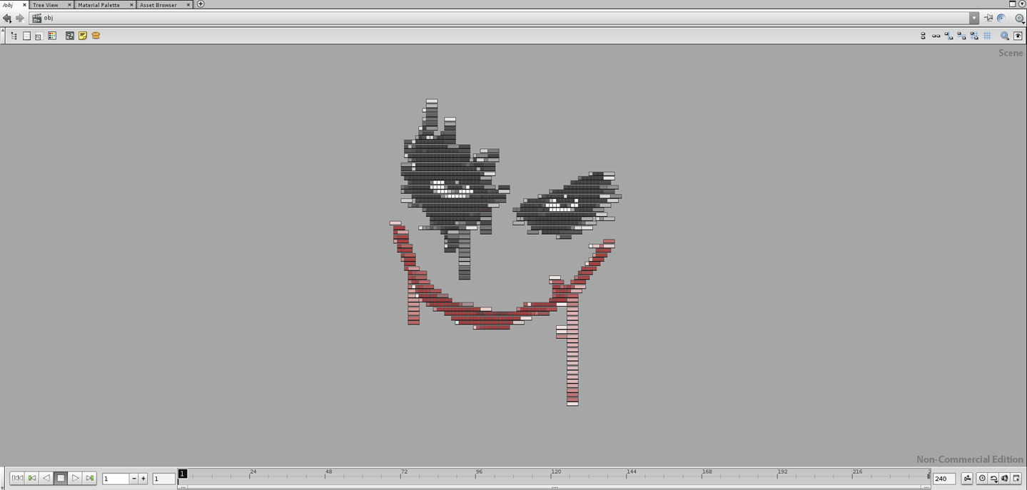

Much Thanks… and here are some more..
the King Himself.. and Our very own Gandalf, the Houdini Wizard..

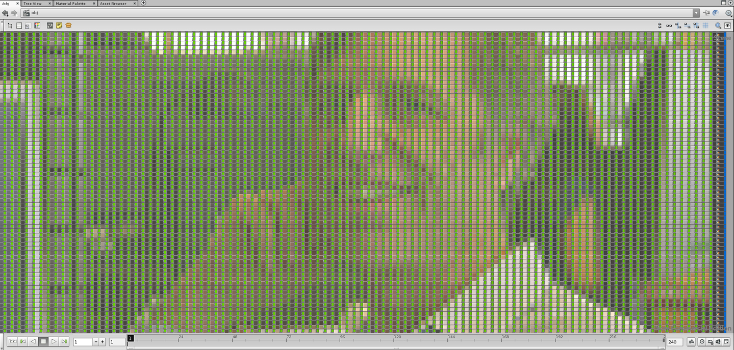

how are you able to get the color of the image per pixel?
I am assuming a script reads the image pixel by pixel and for each pixel drops a node and set that color.

pelos
yup u r partially correct… im reading the image into houdini and converting it to point data so that i can adjust the resolution within houdini. then im using a python script to read that info and created the nodes accordingly.
