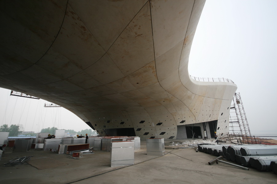

Hello my friends, it is long time since we last met. I did a so called “Parametric Architecture” project in China. And it is almost finish. So I am willing to show you some pictures. Houdini is a so robust software that we can extend its use in a lot of fields in the world

Last Picture, this project is done by a special kind of concrete call by “GRC Concrete” which can be manufactured by 3d digital files.

Nice work….. how hard was it in compaired to a cad system?
48 posts
Joined: June 2011

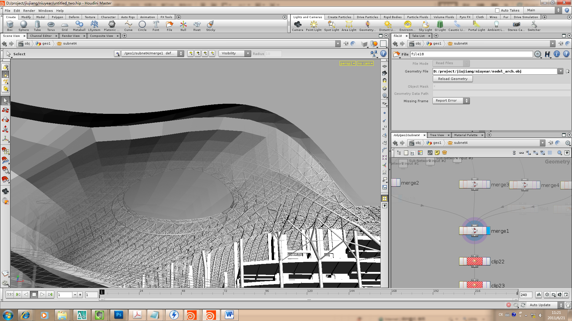

That's absolutely stunning! Fantastic work, and interesting to know you used Houdini. How much of the design process was it used for?
35 posts
Joined:
Pretty cool. Was fabricating the pannels done using data from houdini? or did you have to recreate the pannels in a different application. Will be nice to see your process and where houdini helped.

Hello danwood82, although there are some other softwares uesd in the process, Houdini maybe the most important system in the design and detailing. I develop a node based system which architects can easily change form and pattern of the building and view the result directly.
I post a viewport image here, hope you like it.
Hello imensah, it looks like you quite familiar with the construction process. I am an architecture designer, my job is to make digital file which can pass the information to the manufacture factory. The Houdini file is quite good for digital production. But the 2D CAD drawings which is required by the industry has to been drawed by hand in CAD programs. But I have to say, Houdini did the most important job in the pipeline and we hope it will be used in the future project.

I wonder what file format was used for the exchange between Houdini and CAD.
IGES?
