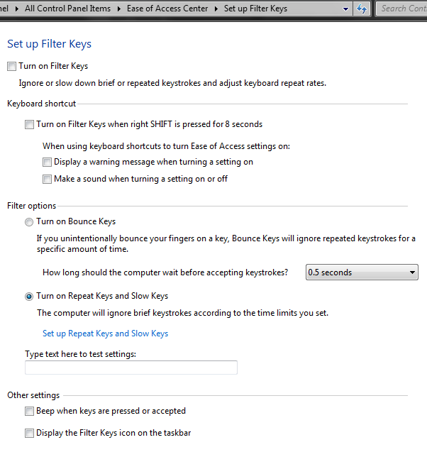

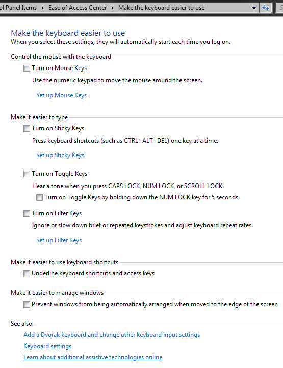

- pezetko
- 392 posts
- Joined: Nov. 2008
It's Windows/os feature.
On Windows 7 go to the Easy Of Access Center, then to the: “Make the keyboard easier to use” and turn off (uncheck) everythink here.
Restart Houdini to see the effect and it should be ok.
This is my settings and it works as should, no continuous playback from holding left/right arrow key.
- arvid
- 16 posts
- Joined: March 2014
All of the easy access stuff was already off, but the one setting that did seem have an effect is the repeat rate in the regular keyboard properties..! Might have been one of the others settings in combination because now I can't get back the faulty behaviour, which doesn't matter
