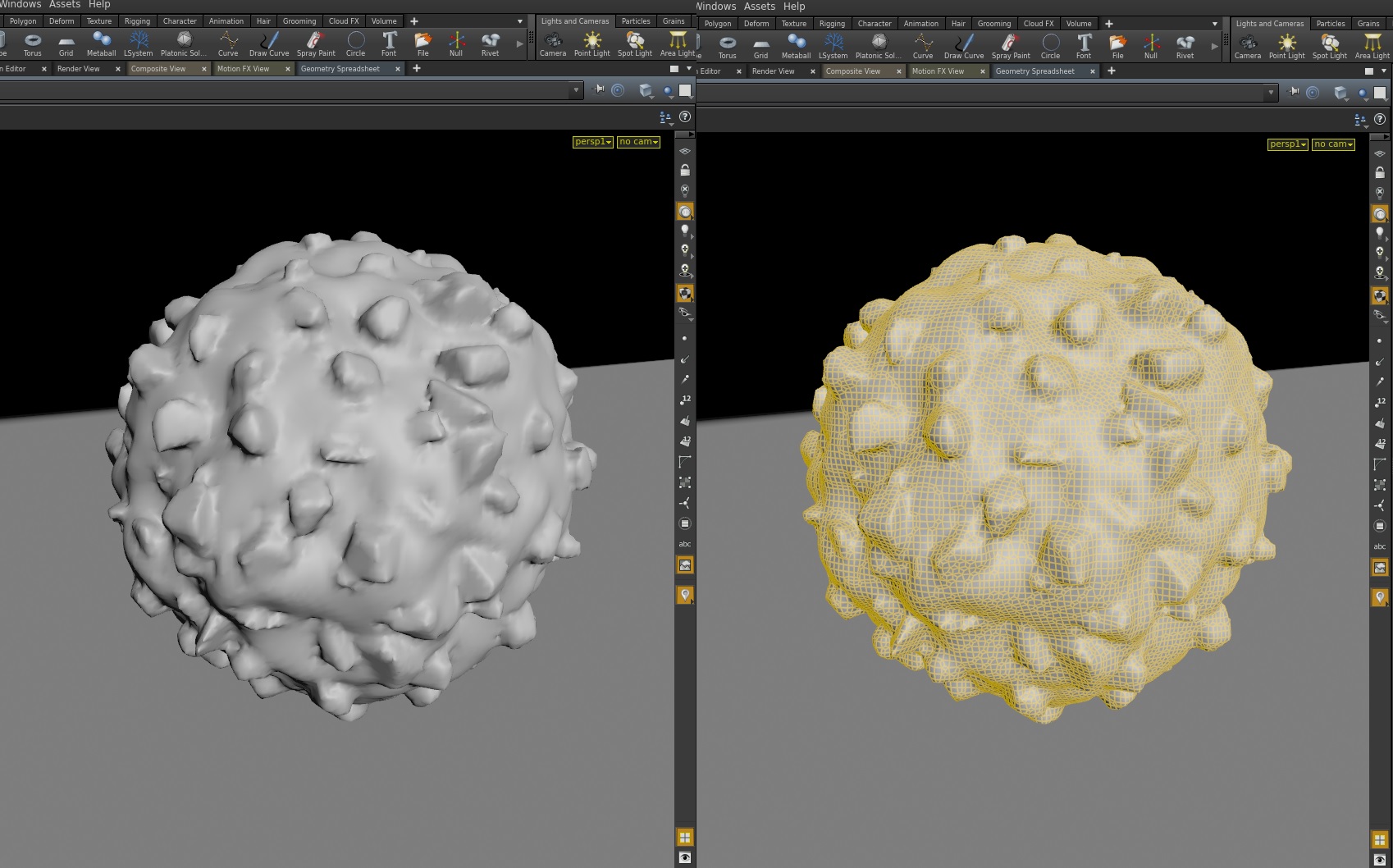

Hi guys!
I have 1 object, a ball with spikes around it. How do I apply a different material on the spikes? Say I want the ball to be wood and the spikes to be metal? and there are too many spikes to select individually and everything is one full geometry.
How do I work my way through this?
Does bounding box work in this case?
Thank you,
Tanner

It's not spikes, just using spikes as an example.
The object is a whole. It's modeled in Houdini, it's a VDB converted polygon.

You can use a ‘bounding sphere’ in the GroupSop
17 posts
Joined: Aug. 2014
MartybNz
Cool! Thanks for the help. It works!

I am trying for a more ‘art-direct’ approach where I can paint to determine where I want my material to be applied but to no avail.
I had tried using the group paint sop then followed by a material sop with points attribute selected the material still doesn't show up in the painted area.
17 posts
Joined: Aug. 2014
ok, I tried this method for the group paint sop and it works!
First I use a group paint sop to paint ‘group’ a specific area, then i use a group sop to convert the selected group from points to primitives and finally apply a material with that group as selection.
