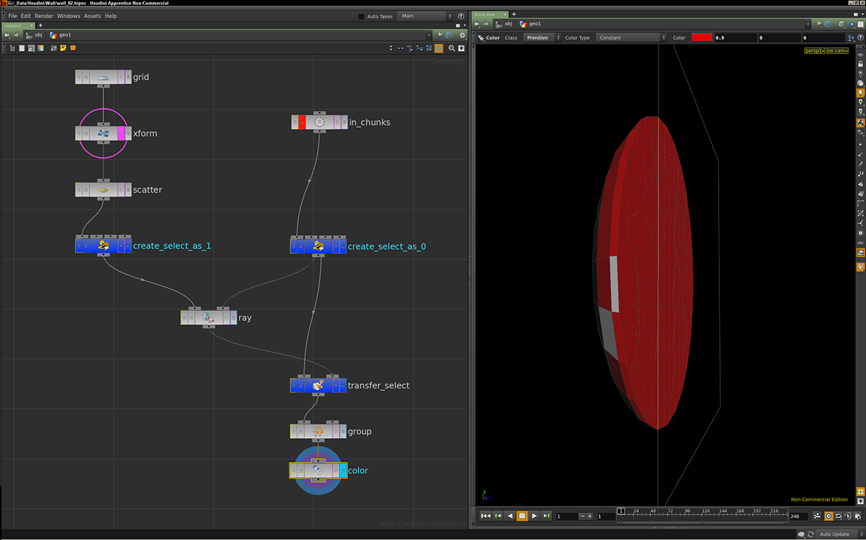

is there a way to select faces that are pointing specific direction/object?
I'm trying to create Bullet sim and then emit some smoke from the exploding chunks. Now, i forget to add inside groups in Voronoi Fracture, and instead of enabling it and resimming and writing the geo into disk, i decided to use the geo that i have and educate myself and hopefully learn something new and find a way to select the inside faces other way.
I tried to use the Ray SOP, and then use some attributes and transfer them, but it doesn't seem to work quite as well i hoped…or i'm not using it correctly: it seems to select a bit more than i need.
Any ideas how to select only the polys that are facing the grid? Using Ray SOP or something else.

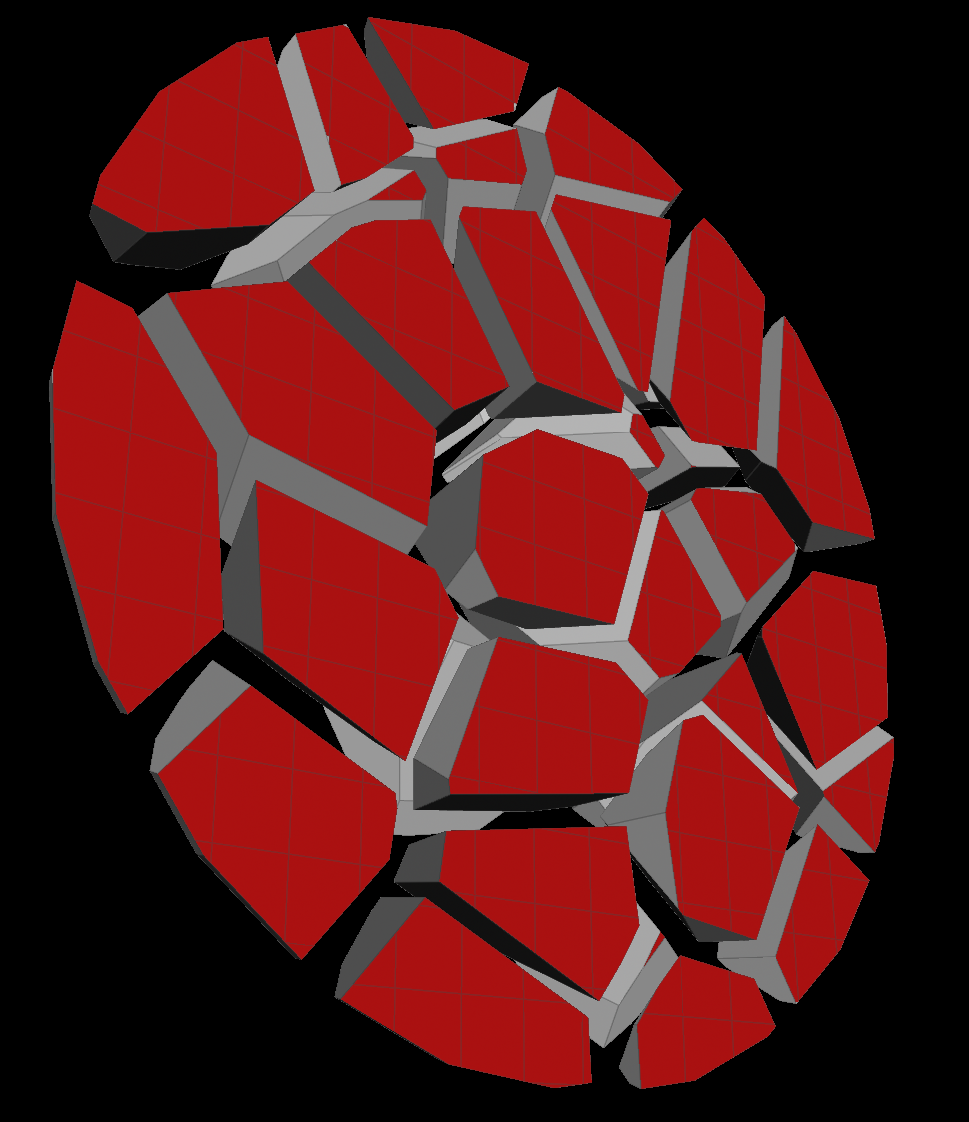

Thank you, but not quite what im after. Hopefully the attached images explains it better
I want to select all the red faces (manual selection here) and then use rest for sourcing smoke
-kimmo

oic, replace wrangle code with:
vector nn = normalize(@N);
vector op = @P + (nn*0.0001);
vector huv = set(0,0,0);
vector hpos = set(0,0,0);
nn = nn * 0.2;
int hit = intersect(1,op,nn,hpos,huv);
@Cd = set(1,0,0);
if (hit >= 0) {
@Cd = set(0,1,0);
setprimgroup(0,“inside”,@primnum,1,“add”);
It switches the target geo to 2nd input, shortens the ray to 0.2
