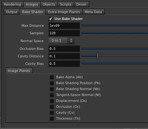

@MagnusL3D: Thinking some more about the formatting of the output images, it might be difficult to second-guess what users need. Adding too many controls to the UI may also be more confusing than helpful. If you're Ok with the script approach I think this might be best. This way you're free to do any post-processing (renaming, conversion) you like.
The output geometry would likely be a parameter just after the ‘Output Picture 1’ path, under the ‘UV Render Objects’ list. The default path will be empty, meaning no geometry will be output.
In terms of flipping the normal map channels, this is something that is already possible with the VOP but has not been exposed in the Bake Shader; I can add this. When you say “-invert Cd” for roughness, what do you mean? Inverting the color?
There is one small UI change coming: the image planes that are related to the Bake Shader have been relocated to that tab to make things clearer (ie. they are only relevant for that shader). I'll look into adding the script and let you know once there is something to test with. Thanks for all the suggestions

@MDavies, ah thats nice, I always have to look for where the image planes are located when doing a new scene
Yes the script sounds like it will be the most flexible way of solving it, looking forward to test it to see if I can get out what I want
regarding invert -Cd for roughness, this is usually just a grayscale image anyway and the more white the more rough, but here for some reason they changed the map into “smothness” maps, so more white means more smooth.
And I think the same is true if you are using the PBR spec/gloss game shaders that have become popular as of late.
Sounds great if the flipping normal map channels are exposed !

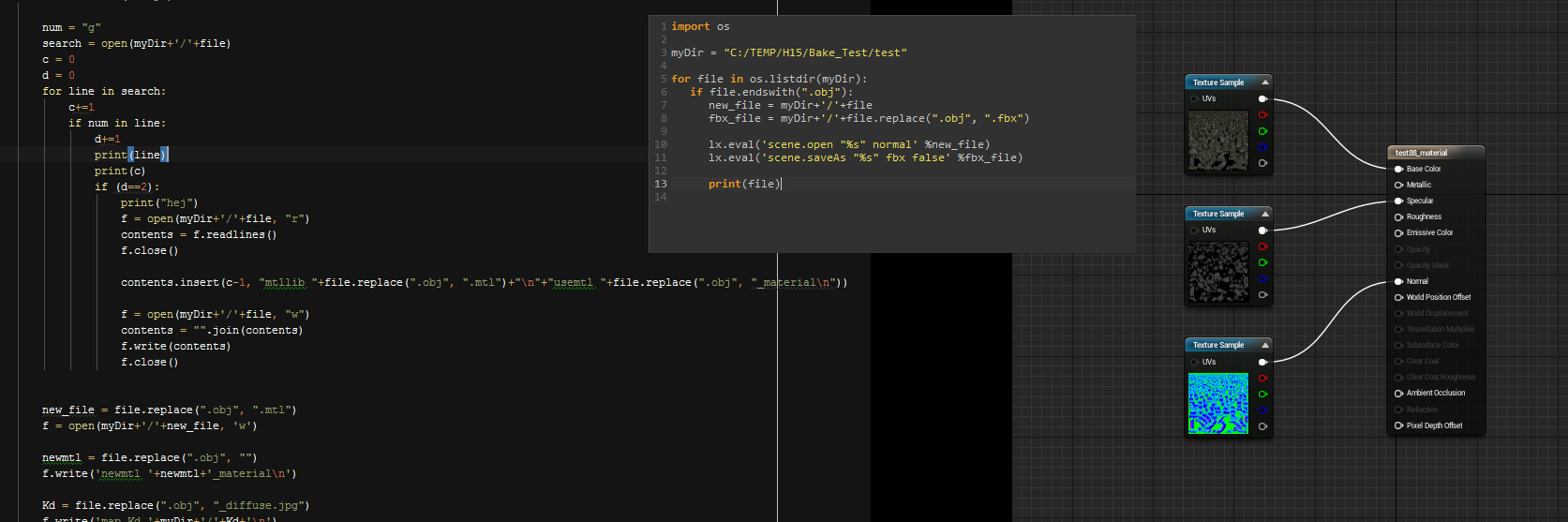

And here is my new “dirty” way to get some automatic things going..
First step is obviously to bake out .obj file and textures.
something similar to:
object_01.obj
object_02_diffuse.tga
object_02_specular.tga
object_02_roughness.tga
object_02_normal.tga
then since Houdini .OBJ saver does not write a .MTL nore assign a link to the none existing .MTL inside the .OBJ, I have written a python script that goes through the directory, inserts the link into the .OBJ and creates the .MTL based on some assumptions regarding file naming etc.
Onto the next problem. The UnReal .obj file importer can automate material creation, but it seems to only support the diffuse (map_Kd) in the .MTL file format. And the Autodesk FBX converter seems to suffer from the same limitation.
However if I open the .OBJ files in Modo with my generated .MTL files from the previous python script. all textures are assigned correctly.
So I wrote a small python script in Modo which imports the .OBJ files and saves them out as .FBX files. which then get the automatic material creation in Unreal to work.
Attached image shows the first itteration of it. since then added some more features like fixing scaling and rotation in Modo for the mesh.
object_01.obj

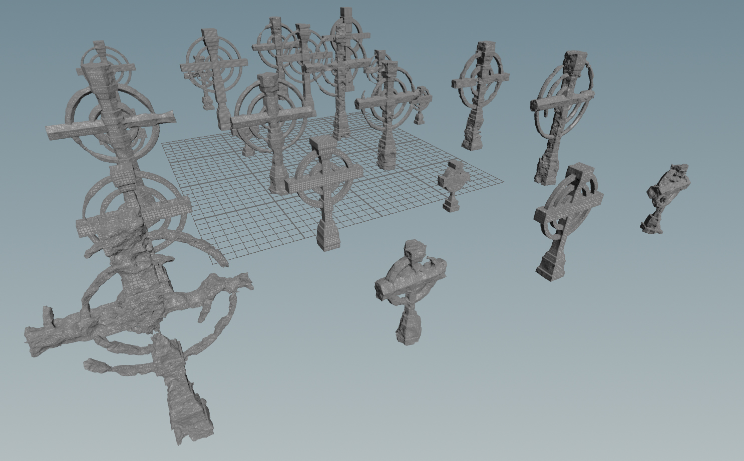

And in the spirit of sharing idea's I came up with this.
Since my procedurally generated crosses are of different size I put down a meassure SOP, promoted the primitive “area” attribute with a Attribute promote SOP set to “sum”, and then put this crude little thing in the Bake ROP resolution:
r_size = detail(“../../obj/Setup/Lo_Res/”, “area”, 0);
out = if ( r_size > 9, 2048, 1024);
out = if ( r_size > 28, 4096, out);
return out;
So now depending on the size of the generated object it will switch between baking at a 1024, 2048 and 4096 texture.
Speaking of which, I did some test renderd of my crosses that later will be baked that you can see here:
https://www.dropbox.com/s/czfsvd7v3kxurhw/CrossGen5.jpg?dl=0 [dropbox.com]
return out;
