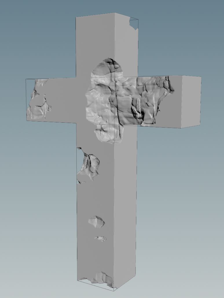

Got a idea today that gives more “structure” with my Procedural Sculpting in OpenVDB. looks very promosing in my mind.
/M
Personal Houdini test videos, http://vimeo.com/magnusl3d/ [vimeo.com]
1269 posts
Joined: March 2014
That looks great Magnus. Care to share how you did it?

1112 posts
Joined: Aug. 2008
@Werner: I setup a triplanar projection inside a Volume VOP and let that drive the amplitude of a Noise. So rather simple realy.
