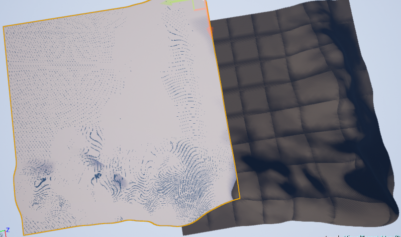

As far as I can tell you already have the option to Input an UE4 Landscape into an HDA via Houdini Engine, but unfortunately I could not get it to work.
Could you please give a brief explanation on how to use this?
I attached a screenshot on how I tried to set it up in UE4. I have an object path parameter that by default points to a mountain geometry (deformed gird) inside the HDA. I scatter some instanced boxes on that. I thought if I point the parameter to the UE4 Landscape the boxes would be scattered on there.
Maybe it's a matter of how I set it up, maybe I am not getting polygons from the landscape but something else and my procedure is not designed to use that.
And how would one “Commit landscape geometry and connect it to host asset.”? And what exactly does it mean?

Most likely it is a bug somewhere, I will have a look, we are still in the process of testing / working on this.
I am not sure about your screenshot - UI looks outdated. Are you running the latest build?
When you select landscape type input and then select landscape from a list, it will send landscape vertex data to the asset as point data. At the moment we only send point data. You can use that point data to instance things inside the asset.
'Import selected parts only' - will send only selected parts of landscape (using mouse selection).
'Recommit landscape' button can be used to resend landscape data to the asset. We aded it for the time being so you could send your things over if you updated landscape. We will probably automate detection of landscape changes in the future.
There is still a number of features that we are going to add soon (like having an option to send actual geometry, not just vertex/point data), send UE4 component information (grid information) as well as send material related stuff.

I was running 15.0.329. I updated to 15.376 and it seems to work, but I still have issues:
Once imported the points seem to be scaled into 0 to 1 space or something like that. In the screenshot attached, I got the scale to match by multiplying the scale of the Landscape input by 100.
The output is a fairly dense point cloud, but what would be a consistent and efficient way to turn those points into a surface in Houdini? My method would be to copy metaballs to the points, turn that into a mesh and process it further, but that leads to all kinds of issues. I guess there is a way that I could use inherent point order to create a clean polygon mesh, but I can't quite figure it out.

Yes, we had a number of bugs to fix in landscape input code.
We fixed scaling and added a number of features, please see here:
https://github.com/sideeffects/HoudiniEngineForUnreal/issues/7 [github.com]
It sounds like you want to enable full geometry option to get the mesh data. If you don't enable it, only the point data will be marshalled in. In that case you would have to remesh it (we also do marshall in normals, so it should be easier).
Please note that you can select individual landscape components through selection tool and if you have that option enabled we will only marshall selected geometry. This makes it much faster than marshalling the whole landscape.
We are still in the process of adding features, mainly landscape materials and UVs.

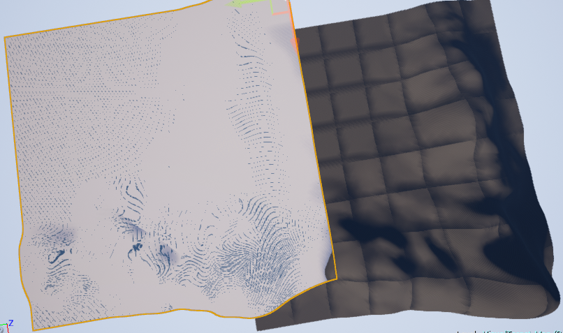

- Move the points to @P.y=0 and store the original @P.y
- Triangulate2D SOP
- Move the points back in P.y
I can't seem to get rid of the triangulation, but aside from that the method seems quite efficient and precise.
Is there now a way to deform the point position data (and possible other attributes) and push that back onto the Input Landscape or a new Landscape? How would I do that, exactly?
Best regards
- DASD
- 490 posts
- Joined: Feb. 2013
If I am not mistaken this is no longer necessary. Set your input to Landscape Input and activate “Export Full Landscape Geometry”. Then you get a triangulated mesh into your HDA.
I attached a test HDA that also has the triangulation method that I described. I tested this with UE4.13 and Houdini 15.5.651
Tell me how it works for you.
