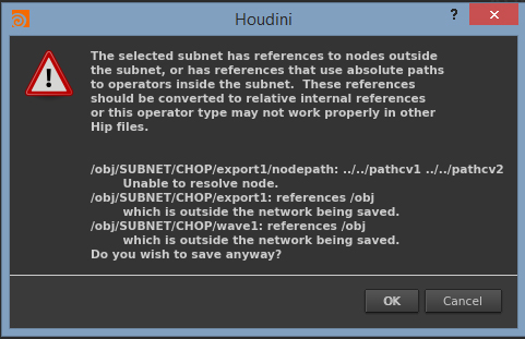

I was hope someone might be able to help me understand the warning/error messages I am getting when creating a subnet to make a digital asset.
I've watched the 6 video tutorials but none of the content seems to shed a light on the “problem” I am looking at.
I have a Chop network that has a wave and export node.
I also have 2 pathcv nodes that are driven by the Chop.
In screenshot “A” below I get that error message shown when I go to create the digital asset ( right clicking the subnet > create digital asset ).
So it's telling me that I am using nodes outside the subnet or that I am using absolute paths.
What I am using is as in screenshot “B” ( the export node of the Chop network )
These are relative paths.

The reason I tried shortening it like this is because the absolute path is:
“/obj/SUBNET/pathcv1 /obj/SUBNET/pathcv2”
So going by what the warning message is saying I am assuming the “/obj” is the part that is outside the subnet and if I remove that then it should not be considered outside the network.
But again, the code fails to work if I “shorten” it like that.
So I've tried variations of these two paths, but these 2 are the only ones that allow my code to work but both give the same warning message:
“../../pathcv1 ../../pathcv2”

Hi arctor,
Thanks for the reply, hopefuly your still on and might be able to answer again.
Even if I do what you said I still get an error message, although it just seems like a shorter version of the orginal.
The first screenshot is of this “new” error message.
I only have 2 nodes in my chop and in both I eliminated anything in the Export Prefix parameter.

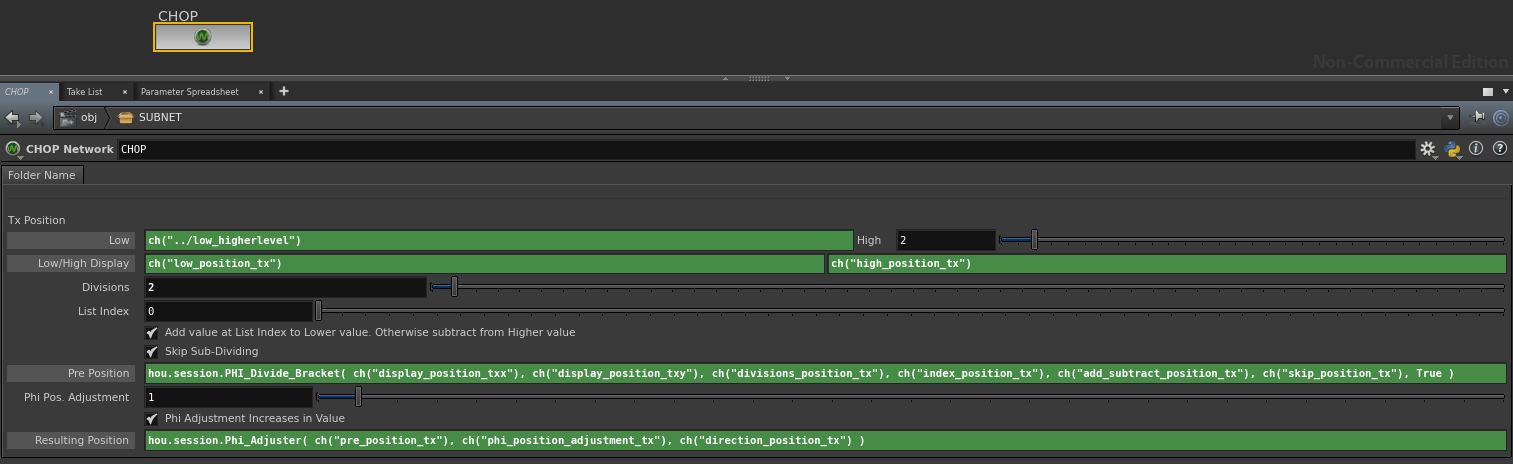

Just to be sure I looked in all my other nodes as well to make sure everything is set as relative paths and I've included screenshots of everything that has any parameter reference to another parameter.
I was thinking, in one of my parameter references I am using a function that is in my Python Source Editor.
And even though the function is using relative paths for it's arguments I thought I may have read somewhere saying we can't use code that is stored in Python Source Editor when we are going to make a digital asset?
Is this true? It would make sense as that code does lie outside the subnet and maybe that's why I get the error message?
Maybe I need to take that Python Source Code and put it in Python Nodes within the subnet?

thanks for the file…
there are a few things going on here…and one of them is a bug
I've attached the hda with my changes
I've taken your python code and added it to a pythonModule in the hda
see : http://www.sidefx.com/docs/houdini15.0/hom/hou/HDAModule [sidefx.com]
then changed the two expressions on your CHOPnet
node_type = node_type = hou.nodeType(hou.objNodeTypeCategory(), “path_test”)
node_type.hdaModule().PHI_Divide_Bracket( ch(“display_position_txx”), ch(“display_position_txy”), ch(“divisions_position_tx”), ch(“index_position_tx”), ch(“add_subtract_position_tx”), ch(“skip_position_tx”), True )
the warning you're getting when you save the hda is actually a false positive
Houdini is reading the Node parameter of the Export CHOP as being an Operator Path Type - which accepts only ONE node (../../pathcv1 in this case)
adding two nodes manually isn't wrong, ad obviously works.
but when you save the hda the fact that thee are two nodes in there throws the warning.
this is the bug I'll add.
