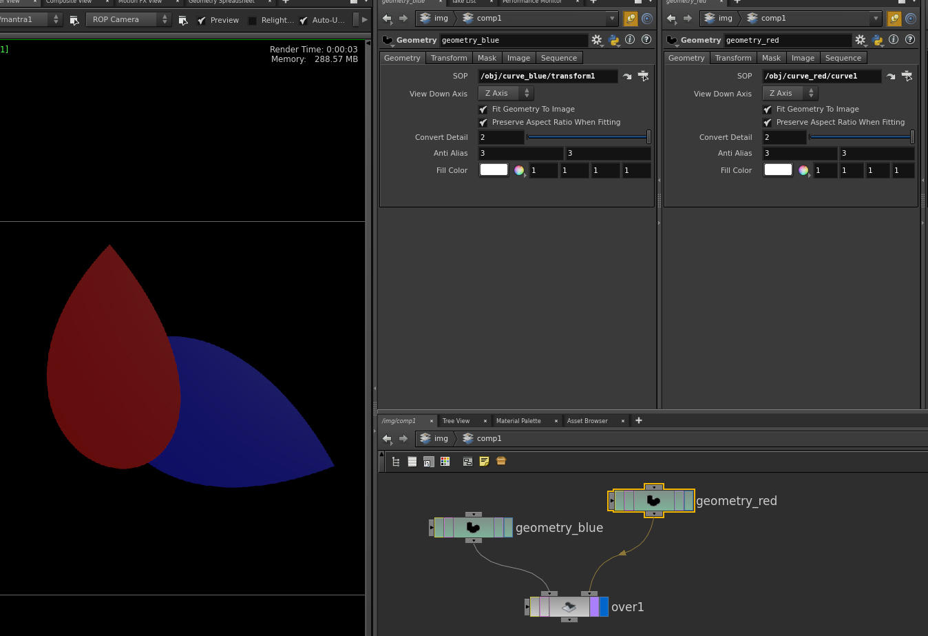

I've tried a more simple set up but still can't get the desired result.
I bet it's just a matter of my inexperience and just need to work with COPs more.
In the file I set up the two shapes on the same plane; One red and one blue.
By default without a COP network the red ( because it was created first I suppose ) overlaps the blue with a render.
So in the COP to try to set up the blue shape to overlap the red explicitly. But it doesn't seem to produce any result in the render.
