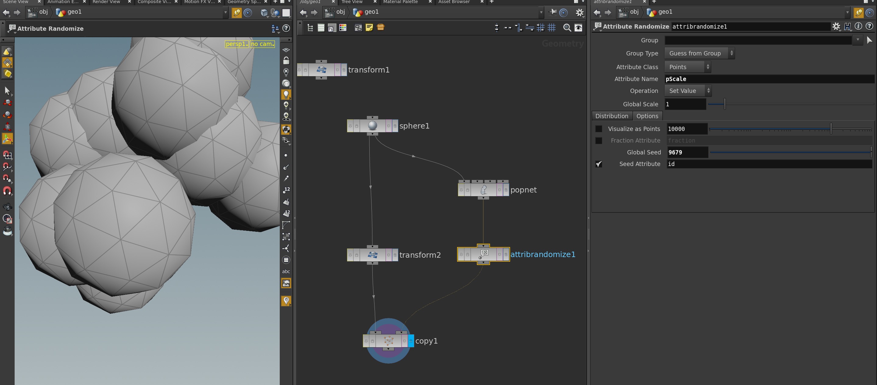

Thank you! Added the Attribute Randomize SOP after the dop network but Im not sure what do from here..
Screen Shot 2017-02-09 at 3.18.53 PM.jpg (330.7 KB)
478 posts
Joined: Feb. 2012
is not pScale is pscale.

pscale
I would like to have random sizes on the spheres emitting from the pop network. It was working with the stamp until the particles died, obviously that can't work because the point number changes.
Thanks you for helping me on this.
