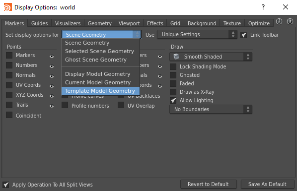

DaJuice
You actually have full control over this in the display options (hit ‘d’ in viewport). Tweak the settings in “Set display options for”, “Use” and “Draw”.

This is the same exact issue I've encountered. I was struggling to find a "workable" way. And I exactly found this :
1-Display Options on viewport (D)
2-Set Display option for "template model geometry"
3-Under Draw column : select "smooth shaded" or "flat shaded", depending on what you prefer
4-Under Draw column : activate : Lock shading mode / Ghosted / allow lighting (any other option is not necessary)
5-Set node of the object reference to "Selectable template" on the template flag
While the Display Options is interactive, you can test the result without closing this windows. When you get the right parameters, it's ok !

Necro.
Im just going to add to this because I found that it wasnt specific enough and I had some trouble until I found it.
Specifically - D > display options
Marker Tab, at the top set "Set Display Options for" > Set this to Template Model Geometry.
Then on the far right where it says "Draw" > I changed this to Smooth Wire Shaded + Ghosted checkbox on.
