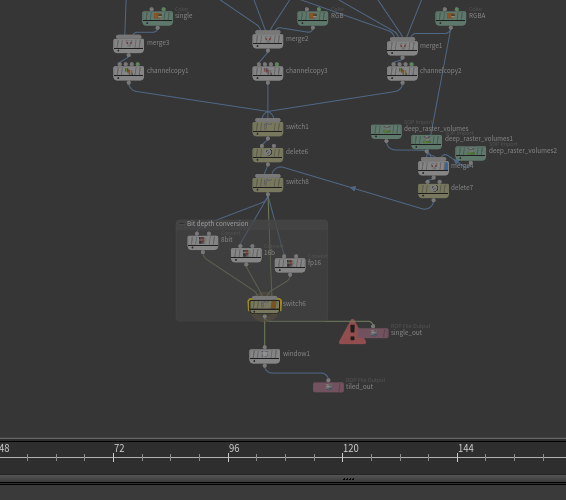

New to houdini but not 3d in general. Wondering if im doing something daft but after connecting a heightfield output to the end of my heightfield network I set my filename and output settings and press save to disk nothing is happening, any ideas?

screenshot of workspace

the problem seems to be “cook error in input”

if you middle mouse button on the SOP that has the error it should provide some information

Yep, my error is “cook error on input:”. Moves up the chain as i bypass nodes right up to the rgb inputs. Leads me to think there is something i need to do to the input nodes but i only have a heightfield and heightfield noise. Do i need to convert in someway before i save the image file?

ah damn, just looked closer at your image - you have to provide a file extension to your filename…
terrain.exr etc

Ah, ok will try this too, thanks for your help. Did select one from the drop down menu but guess i have to input it manually?
14 posts
Joined: March 2017
yep, that was it. thought i was missing something simple. Just had to type the file extension at the end of the output file name, thought i was actually setting that in the file browser with the drop down menu. Thanks again arctor
