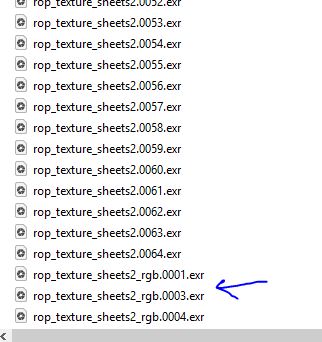

I've been getting issues as well. The render node spits out the texture sheets, but when it gets to the “_rgb” versions, it will skip frames randomly and gives me errors when it tries to create the mosaic. I've downloaded the most recent versions of the game tools and followed your instructions above, but this seems like a bug. It gets through the “checkpoint” process, by the way, then deletes the final exr file.
