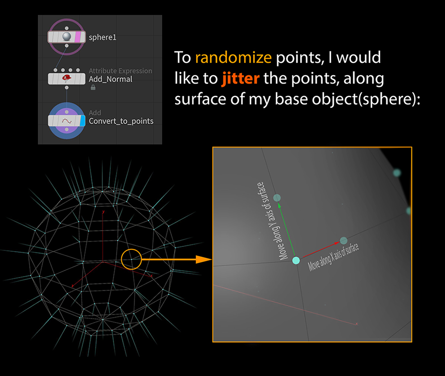

In my simple test scene, I converted a geometry(sphere) to points, then I add a “Point Jitter” sop to it.
The “Point Jitter” , moves points randomly along local axis of geometry, but I want to move them along NORMAL of each point.
I don't want to use Scatter, because I want the points exactly on geometry's points.
Any idea?

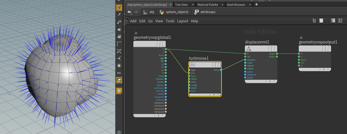

Jitter along normal is just displace, right?
There is Displace Along Normal that you can construct inside a VOP.
Or just throw down a mountain SOP.

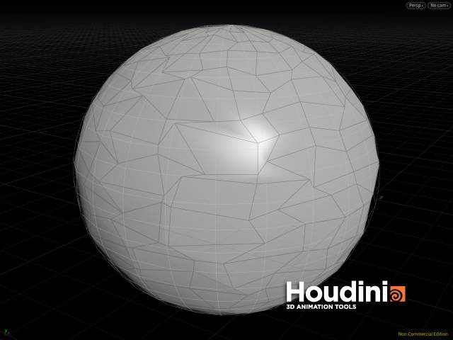

int seed        = chi('seed');
vector shift    = rand(@ptnum + seed);
int prims_nb[]  = pointprims(0, @ptnum);
float prims_num = 1 / float( len(prims_nb) );
int prim_choose = int( floor(shift.z / prims_num) );
int prim        = prims_nb[prim_choose];
vector pos      = primuv(0, "P", prim, shift);
@t = prims_num;
@P = pos;
pointprims tells you what primitives are connected to each point. with prims_num, prims_choose and prim the third component of a random value named shift gets assigned to one of those primitives. the first and second components of shift determine the UV location on the chosen primitive. Change the seed to get variations.
If you want it less overlapping, just set prim_choose to 0 and maybe delete prims_num.

Hi Enivob and thanks for reply;
I don't want points leave the surface, so Displace or Mountain doesn't works.

Hi Konstantin Magnus;
This is want I need, Thank you.
