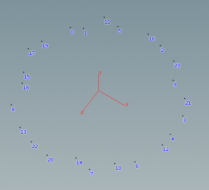

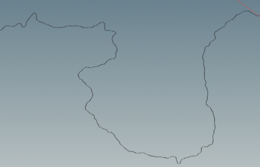

I have a bunch of randomized points, and in this example they form a circular shape, although they could easily be a noisy line. Even though I can clearly see the shape in the noise, I haven't figured out how to order the points so I can add a line across them.
My attempt was to split the circle into 2 halves, and then sort along the z-axis. Although it mostly works, it can still run into problems as shown in the image.

If you have knowledge of the spline, which the points are following you can create an attribute (with xyzdist()) to get the u-value for each point to sort them with it . This works quite ok even for roughly approached splines. But if you have no information to create one, I think some heuristic solutions for the “travelling salesman problem” should work aswell but I don't have much experience in this area.
