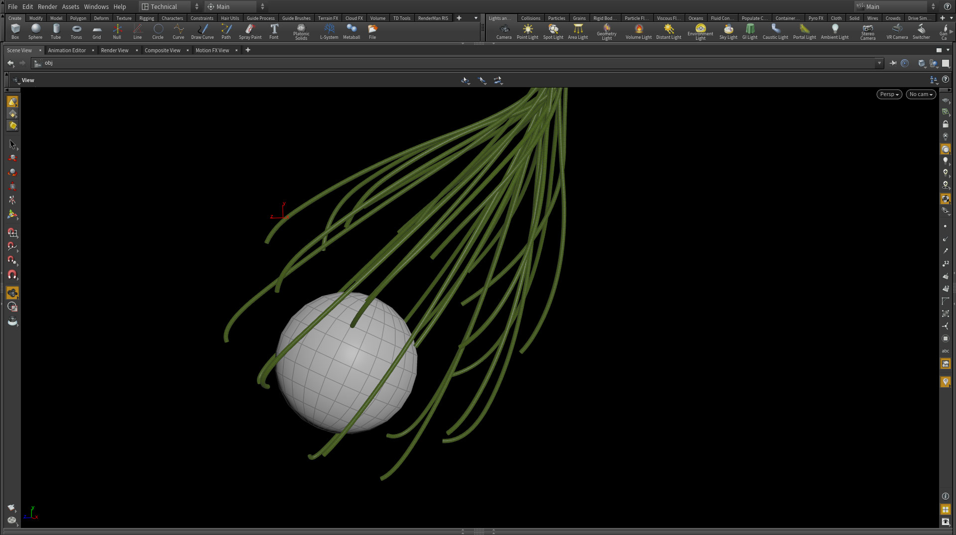

Maybe helpy, too.
Strongly inspired by: https://vimeo.com/104891696 [vimeo.com]
while working on the attached one (tentacles grab moving object)
attached wrangle needs some refinements for proper UVs and
it's for polylines only, but it's really fast in my opinion.
Should not produce unwanted points.
