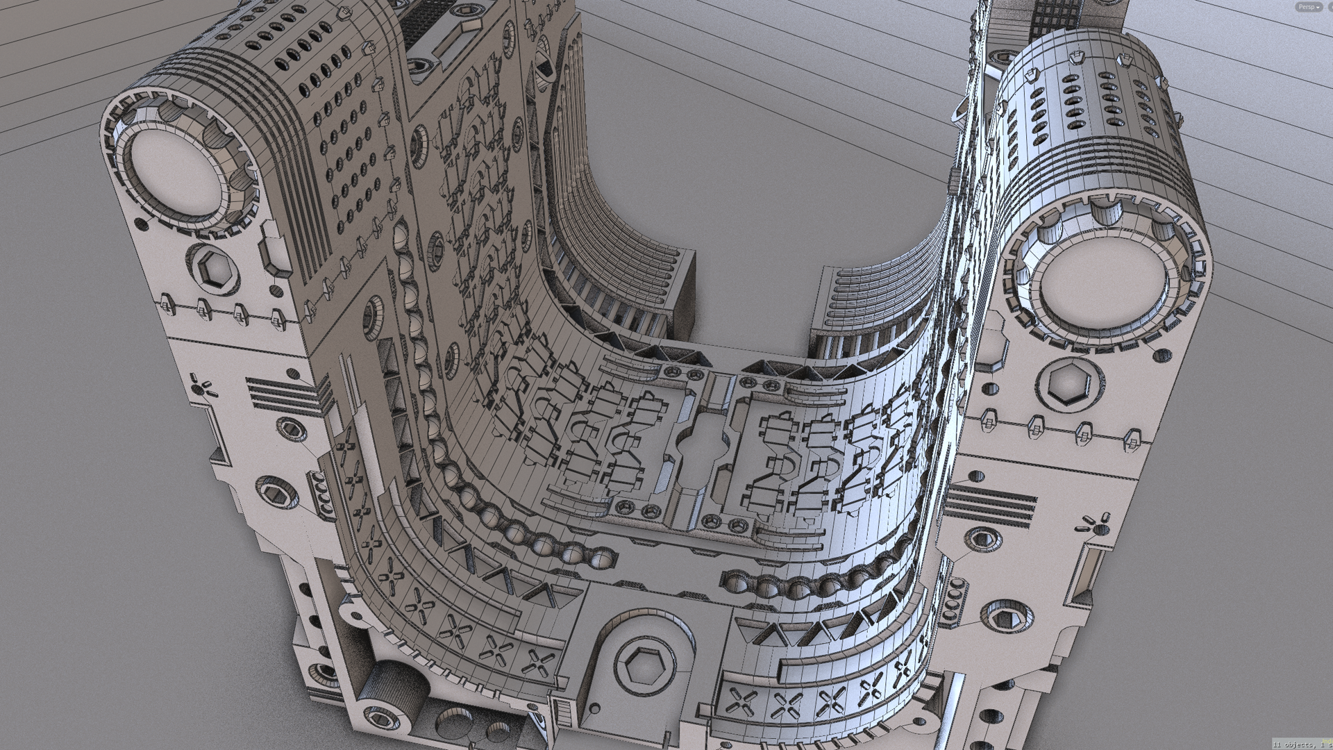

Inspired by HardOps / Fusion 360 / Modo / Modo - Polystein etc. I made myself some HDA (tools) in Houdini to help myself model more efficiently in Houdini. This is the results so far, I've used a base shape I saw in some HardOps post since I thought it was a good test case for the different HDA's (tools).
The HDA's (tools) so far I've named: ‘edge sweep’, ‘edge clone’, ‘edge warp’, ‘mesh_split’, ‘hex_screw’. They all revolve a lot around beeing able to create interesting mesh to use with Boolean rather quickly. And the ‘mesh_split’ I have done to facilitate myself a new workflow where I work from a base shape and split of pieces with the ‘mesh split’ to further refine that inside a ‘subnet’ which helps my node graph in Houdini to not explode into 1 million nodes.

I'm curious, how did you deal, if at all, with the shading artifacts caused by so many n-gons? Did you control the normals for each continuous surface part or you didn't have to deal with shading artifacts at all? One solution to get rid of those shading artifacts is to go Sub-D, but that's obviously off the table with the topology you have there.
- MagnusL3D
- 1112 posts
- Joined: Aug. 2008
McNistor
Looks good!
Thanks! The way I deal with shading this thing is just using the Normal SOP with the “Weighting Method” set to “by Surface Area”.
