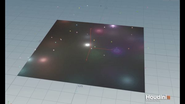

Coming from this one https://www.sidefx.com/forum/topic/51410/ [www.sidefx.com] so I don't hijack my own thread.
I got lucky because I could get the world position from the uvs. In the case of an arbitrary mesh I'd make a grid if points in world space that represent the pixels, do the tricks in sops and then bring the colors to cops.
sopcops.hipnc (202.5 KB)

#2. I'm not sure how that node would work. Look at the cop globals, we need a logic to import data. The most useful are the X and Y positions, analogous to u and v or s and t. So we need to find a correlation between that and world ( object ) space. So what I've done a couple of times before is transform the mesh to uv space and sample attributes from that geometry ( forget the pixel grid I talked about, I got confused with a related experiment ). Of course it needs to have properly laid out uvs.

Hey, this example works great if the grid only has 1 primitive because you're specifying prim 0 in cops. I can't wrap my head around how to make this work for a more complex geometry with multiple primitives. Any idea?
257 posts
Joined: July 2006
Colby Winfield
I just noticed your post … Check updated scene.
sopcops_v02.hipnc (265.9 KB)
