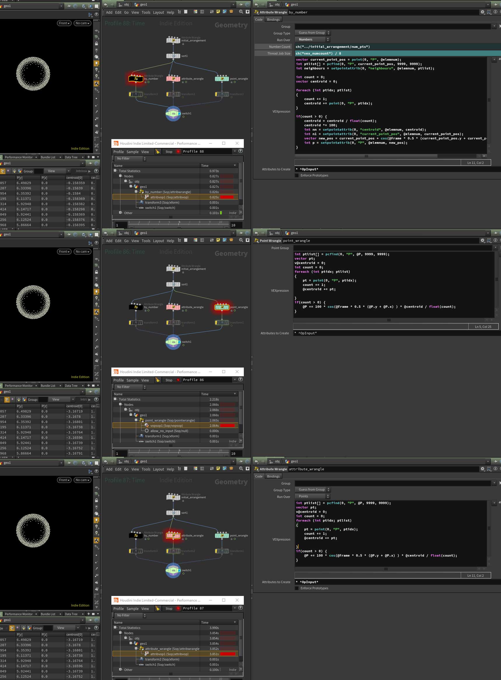

To further isolate the issue, I've replaced the scatter with a simple arrangement of the points done in another wrangle, followed by a sort. I'm eager to try the “Run Over Numbers” mode, but couldn't find an example of how to bind attributes in that mode.
I'm attaching the updated file and a couple of screenshots.

UPDATE: Just managed to get Run Over Numbers to work, and it is massively faster and more controllable! Thank you for the suggestion.
I've linked the “Number count” to the number of points I have, and set “Thread Job Size” to number of points / available threads(8). To make sure the comparison isn't affected by the wrangles competing for threads, I run each on it's own.
Results with 2000 points:
Attrib wrangle run over number: 0.825s
Old point wrangle: 2.064s
Attrib wrangle run over points: 3.851s
Just one more question - you mentioned holes in the point list left by the old scatter sop, how can I tell there are holes in the point list?
