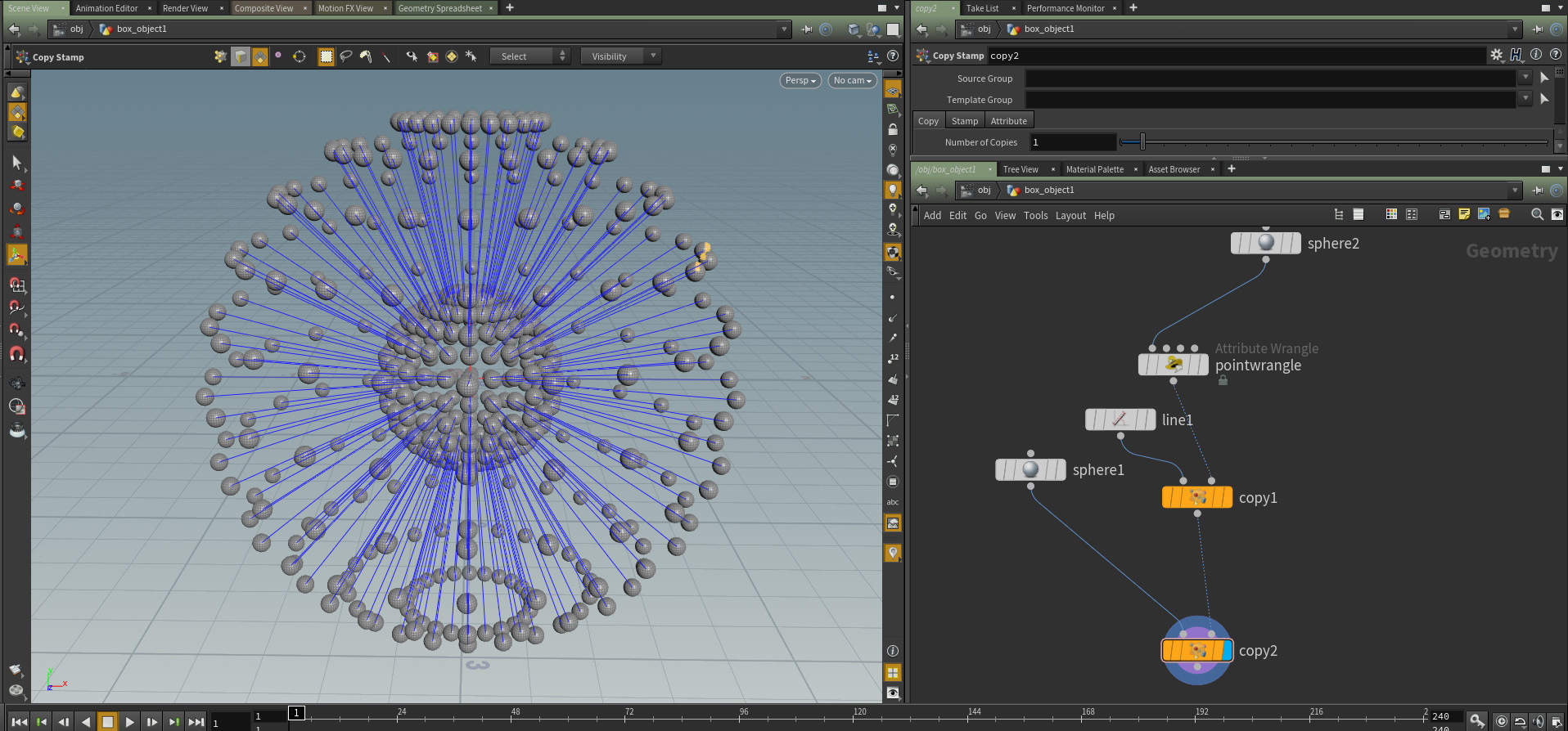

91 posts
Joined: Oct. 2015
@tamte thank you so much that one sweet vex snippet
“vector up = {0,1,0};
vector nN = normalize(v@N);
matrix3 localrot = matrix3(maketransform(0, 0, {0,0,0}, {90, 0, 0}, {1,1,1}));
matrix3 rot = maketransform(nN, up);
p@orient = quaternion(localrot*rot);”
i can do so much with that
for people who new you can just add box then “add pointwrangle add code in the pointwrangle” then drop down a copy stamp “add a ”line“ to right node of the copy stamp ” add the pointwrangle wire"
Edited by gfxfx - Oct. 11, 2017 13:21:34
When you copy to points, the tree should be oriented along the Z axis. You then make sure that the normal node “Adds Normals to” POINTS rather than vertices and you should be good to go.
I know you want to avoid rotating the tree but the copy to points is looking for things oriented along the Z axis so that is the UP vector for the copied objects.
Edited by rmagee - Oct. 11, 2017 18:03:35
